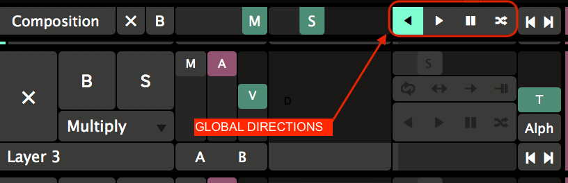

hi i am new to Resolume.
My playback of the clips keep on playing backwards. Even if i change it to play forwards.
Is there a way to put everything on playing forward by default ?
Re: playback stays on playing backwards
p48 of the manual wrote:
Direction Controls
With the global direction controls, you can quickly change the direction for all the
clips that are currently playing. You can switch the direction between forwards or
backwards, as well as set them all to random mode.
Tip! By right-clicking the button you can 'pin' the direction controls. That way, every clip you trigger will automatically be set to this play mode. So when you right-click the R button, it becomes pinned, and every clip you trigger will be set to random playback, regardless of how it was set before.
You can find the global speed and direction controls by choosing View > Show Layer Transport
Controls, they then appear in the top left of the interface.
Note: I deleted your other post as it was a duplicate of this one and it's easier to keep it all under one thread!
Mknoop
Joined: Sun Sep 02, 2018 13:45
Post by Mknoop »
Ah thanks this works !
Was doing it on the transport bar below and it kept popping back to backwards.
