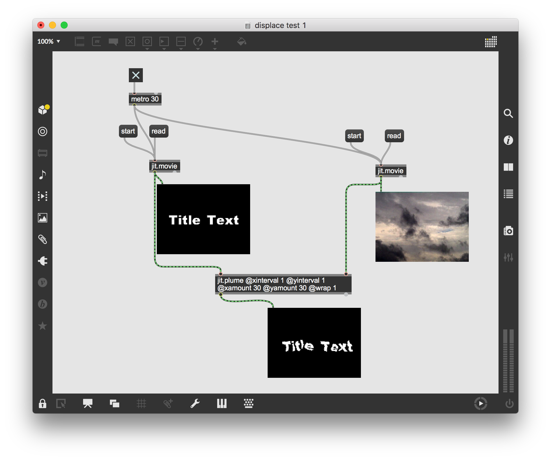

In case it is not clear, here's a video screen grab from Max/MSP doing exactly that. You can do it in After Effects too, very easily. I wish it were possible in Resolume, can't be too hard?
https://youtu.be/Rtn6kxMeLQ4
and a still of the patch in use:
displace test 1.maxpat.zip
(1.58 KiB) Downloaded 639 times

You can not currently do this in Resolume. I imagine it would be possible to create a mixer for such a purpose, the only effect type in Resolume that can take two video sources as input; the current Displace mixer seems to be a different effect to what you have in mind. However, it is much easier to create such an effect in a node-based environment, as you showed in Max/MSP.
