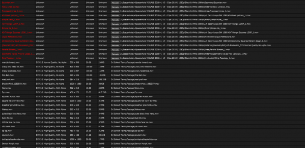

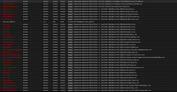

So first 2 screenshots of all the files missing.
If i do a relocate search in the copied footage folder , it does finds them all except for one file.
In the previous attempt there were about 15 files i had to recopy & add , but just one missing is acceptable..

Thanks, are the files you miss or can't reconnect only from the Black & White folder, and all of the files from that folder?
Could be the & that causes issues there.

Not really , as you can see at the top of the second screenshot there are files missing from other source folders aswel.
If the media manager is saying 125 gig but the actual folder is a lot smaller , something is going wrong there ?
I really have no idea what could be causing this , i'm playing the clips often without problems , all is dxv3 normal quality , can't find anything odd or a pattern in which files are ignored in the collecT.
As i prepare my shows on my desktop , i got a copy of my "all vj clips" folder on another drive in my gig laptop. , so the files missing are easily reconnected on the gig laptop by pointing to the all clips folder so it's quickly solved but then i got files running from a slow HDD in my comp :(

Grimm90 wrote: Sun Dec 09, 2018 22:14 Not really , as you can see at the top of the second screenshot there are files missing from other source folders aswel.
In your screenshots all the missing files have a & in the path right?
Are these files present in the collected folder?
