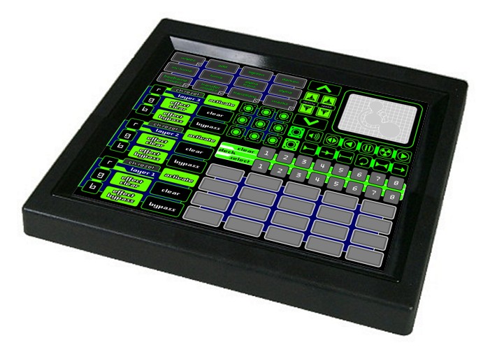

thanx edwin!
trying to keep picture size down so tell me if these pictures are to large for the forum.
the picture I attached is the concept graphic.
It will be real in about a month.
price is gonna come to around $400 US
not massively expensive considering the money I have wasted trying to find the "perfect controller"
leave knobs and sliders for the BCF2000 and BCR2000 this will help me be better organized in the button area.
when the whole unit is completed I'll post a whole breakdown of how well it works, and how you can do it or similar. all the tedious details and some actual pictures.
I am not an electronics guru, just a media designer so that is good news for most of us!

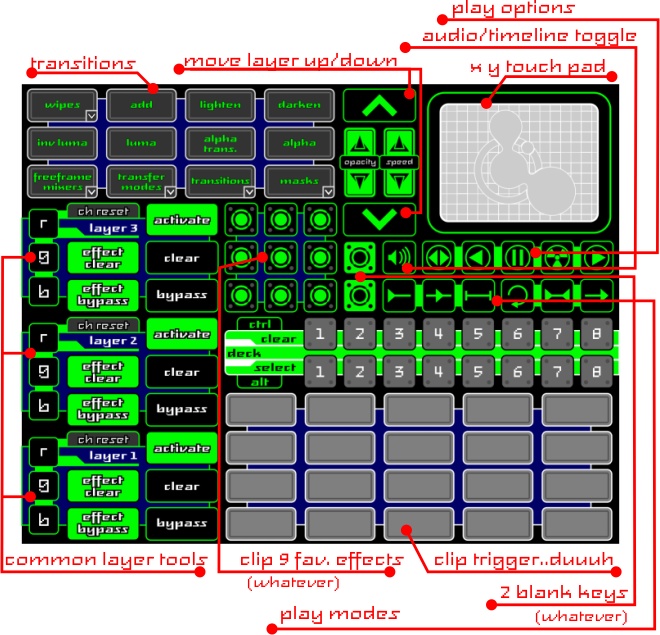

here a topical breakdown of the layout.
(pardon the over simplification of the explanations)

Digital:snot I understand your perspective, making the resolume interface more / faster accessible through a hardware interface. I can give your design a review with a friend of mine who is also a Interaction designer, so hopefully we can give you some usefull feedback.
For now:
- The select/clear of decks, perhaps you should move the clear below channel selection button, is perhaps a bit flaw-sensitive
- A clear channelFX button would be awesome, perhaps even disable / clear within the channel buttons area?
- Clear / disable General FX ?
Will have a closer look at it shortly, awesome project!

Hey Levon,
The xy pad is mouse is a mouse input. I will not being using it for the mouse exclusively, but I felt a touuch pad coupled with mouse track fx slider would give resolume a bit of a "Korg Entrancer" feel...
__________________________________________________
Hey Sense,
Thanx for the input...
"- The select/clear of decks, perhaps you should move the clear below channel selection button, is perhaps a bit flaw-sensitive"
I kept going back and forth with this. The way you mentioned is more technically accurate to resolume. I ended up putting the clip buttons full on the bottom so that in performance I wouldn't HAVE to look at my hand and I could be sure that the bottom right corner would always only trigger a clip ... (sometimes I am a sloppy VJ)
Basically putting it there would make it so I would know exactly where the limits of the clip trigger area are... (ie 2 of them defined by the borders of the unit) without looking...
"- A clear channelFX button would be awesome, perhaps even disable / clear within the channel buttons area?
- Clear / disable General FX ?"
I can't recall seeing those as options in the keystroke dialog option... Originally I wanted to have the layout based on just what was available. (didn't want to contribute to the Bart/Edwin "Gimme list". : )
Personally I used the 3 global effects more than the per layer effects, but the confines of keystrokes options and the fact I had to decide on making the hardware interface be only about individual layers and not global effects. (just due to the real estate of the working surface.) So I designed the "logic" of this interface to be layer driven... not global driven. It really has to be used with a midi controller, make sense?
(oooo bad pun)
there are 11 "Blank" areas... this will accommodate effects or better unforeseen control... because of the limitations of the keypad grid I had to design over, I wouldn't be able to put them in the channel buttons area.
It's funny... thi whole projected started as just getting the 5x4 touchpad grid down cuz NO midi controller offered it.. : )
the button interface is:
9.75 inches(247mm) by 7.50 inches (191mm)
thanks for the input!
sorry about the double post. not sure how it happened.
later
[Edited on 31-3-2005 by digital:snot]

nice
looks really good, though i think the buttons are a bit to close to each other. i don't know how the buttons will feel, offcource it is good when you spill drinks and so on, but there is no real tacticle feedback... i completed a test interface with 45 buttons, used a different layout, i'll post a picture soon... can't wait to see the controller when it's finished
