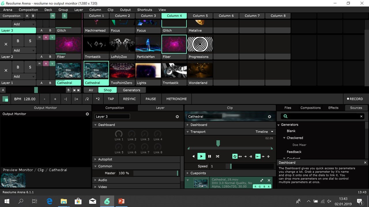

Im running Arena 6, and on one composition I was playing around with, suddenly it was impossible to send any picture to the monitor-output or the Connected display. Everything appears in the preview. I opened the composition-file in other PCs and my mac and same behaviour there. Even if I delete all the layers and use New Clips same thing happens.
Do you have any suggestions of what Im doing wrong? Im guessing its something really simple.
Ive Attached the compostion file if somebody wants to test it. Im just using the Stock Clips. You could also try to import New Clips and see if they show up in the output.

Composition Transform scale is set to 0%, that's why.
mortenstensland
Posts: 10
Joined: Tue Dec 25, 2018 17:37
Re: output not working strange bug
Post by mortenstensland »
You are right that solved the problem. Thanks alot I really appreciate the effort.
