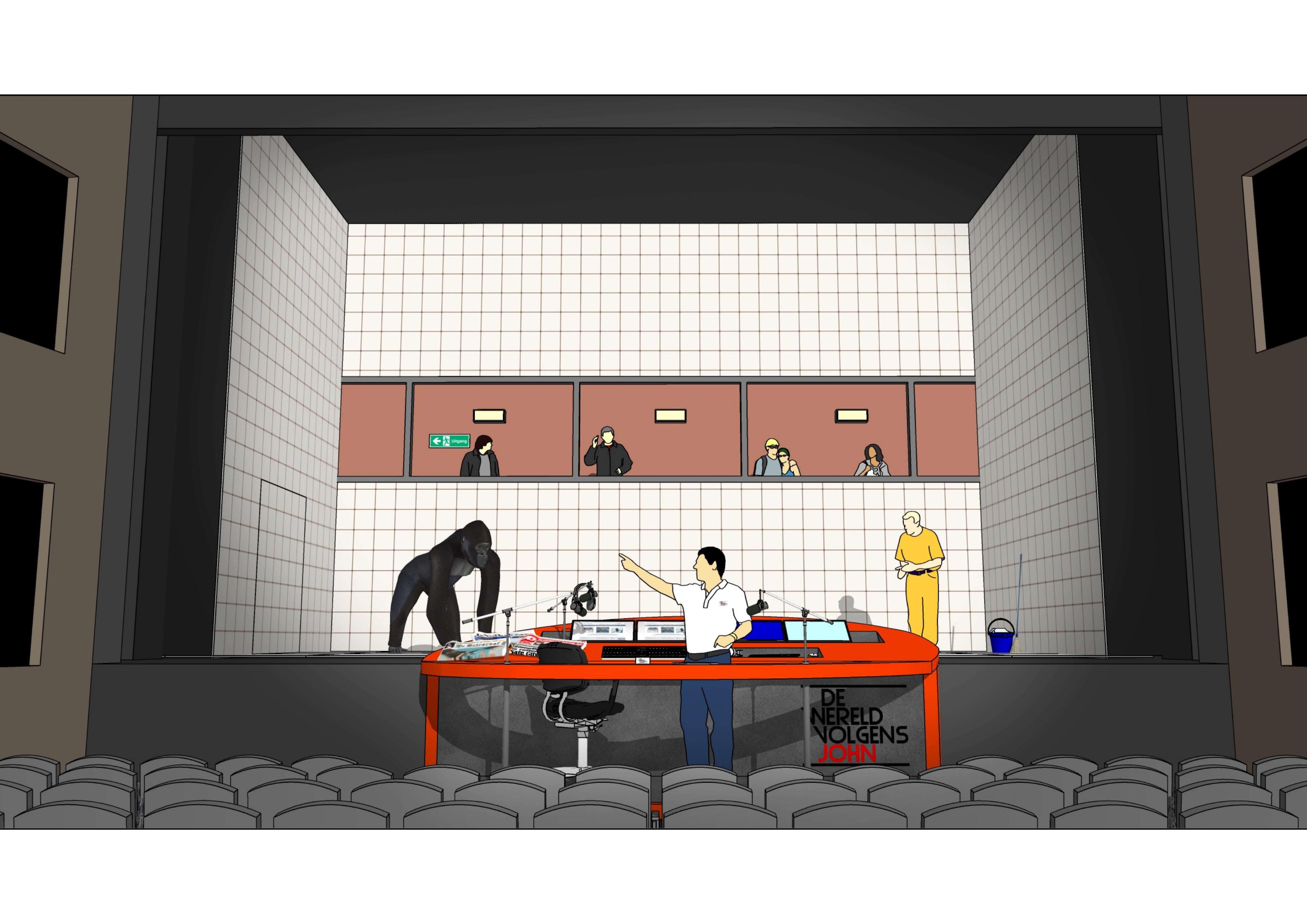

The set :
The set is constructed of a white tile backwall measuring 6.5 meter high and 12 meters wide. The tiles are 30 x 30 cm wide and we will be mapping on the entire surface.
The side walls are 5.1 meters deep and measure 6.5 meter in height. They also have the white tiles which will be mapped.
In front of the stage you can see a small control booth which an actor will stand in for the duration of the show. There are 4 LCD Ful HD monitors in there (1 control Ableton) , 3 to be showing content , social media pages, twitter feed etc (all pre-recorded content).

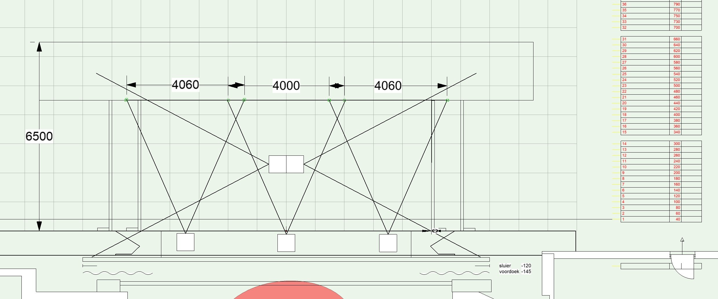

The mapping on the set will be done by using 5 Epson L1505UH projectors which will be rigged vertically. Their aspect ratio will be 10:16 with 1080 x 1920 resolution.

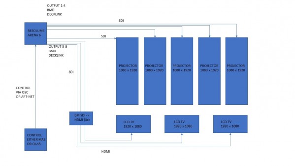

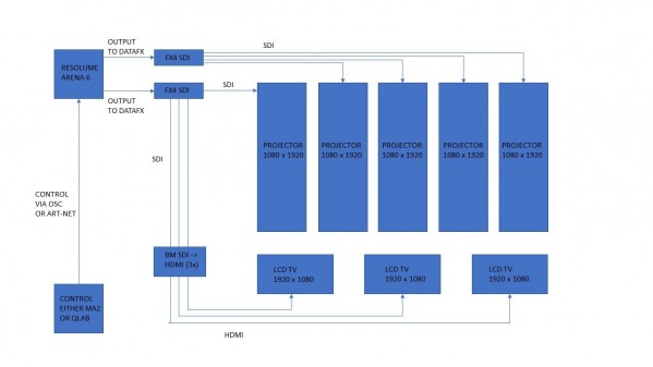

It comes down to the following 3 options
Using the Desktop with 2 Datapath FX4 SDI to all screens / projectors via Resolume
Using the Desktop with Decklink Quad SDI to all screens / projectors via Resolume

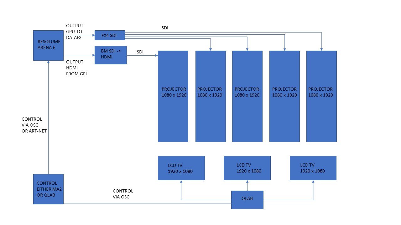

Using the Desktop with 1 Datapath FX4 SDI + 1 GPU output to projectors via Resolume and running the studio of a Macbook Pro using QLAB.
Im new to the world of Datapath and was wondering if this is a viable setup to go touring with? Is the time consuming to set up when we move the show? Or is it as simple as setting the config and then plug and play everytime we move the show?

Edge-blending - I will need to edge blend the 5 projectors together.
Another question : What would be the total composition size for the 8 outputs? The 5 projectors would be 5*1080 (5400) by (1920) since they are rigged vertically, but the 3 monitors are 3*1920 x 1080?

Re: Touring with Multiple outputs - need some opinions!
Sounds like a fun challenge
The edge blending will be a pain in the proverbial, could you get away without it?
Maybe just use one projector for each wall, or one for top and one for bottom of the upstage wall.
The Datapaths do just need programming once so should not cause any issues.
I would suggest using both computers and splitting the load between scenery mapping and control booth screens.
I hope the tiles are not shiney.
Also 10:16 would usually be 1200x1920 pixels
