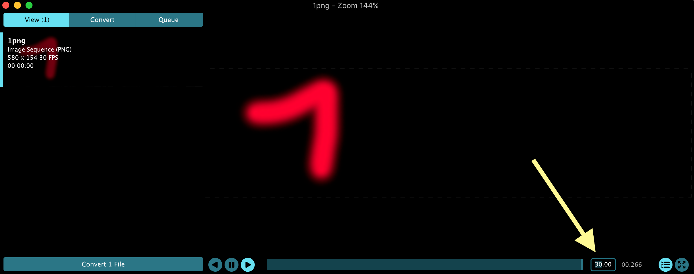

If you drop the folder as Image sequence, there will be an FPS box on the bottom right: Setting this to a value, you can set the frame rate of the clip. Then the conversion of this sequence will happen at the frame rate you set.deflost wrote: Mon Apr 08, 2019 19:23 hello. how can i change the individual duration of every singel picture? when i converz a subfolder of pics to one dxv video?
If you need to do different durations for every image, I'd suggest to use a video editor instead.
