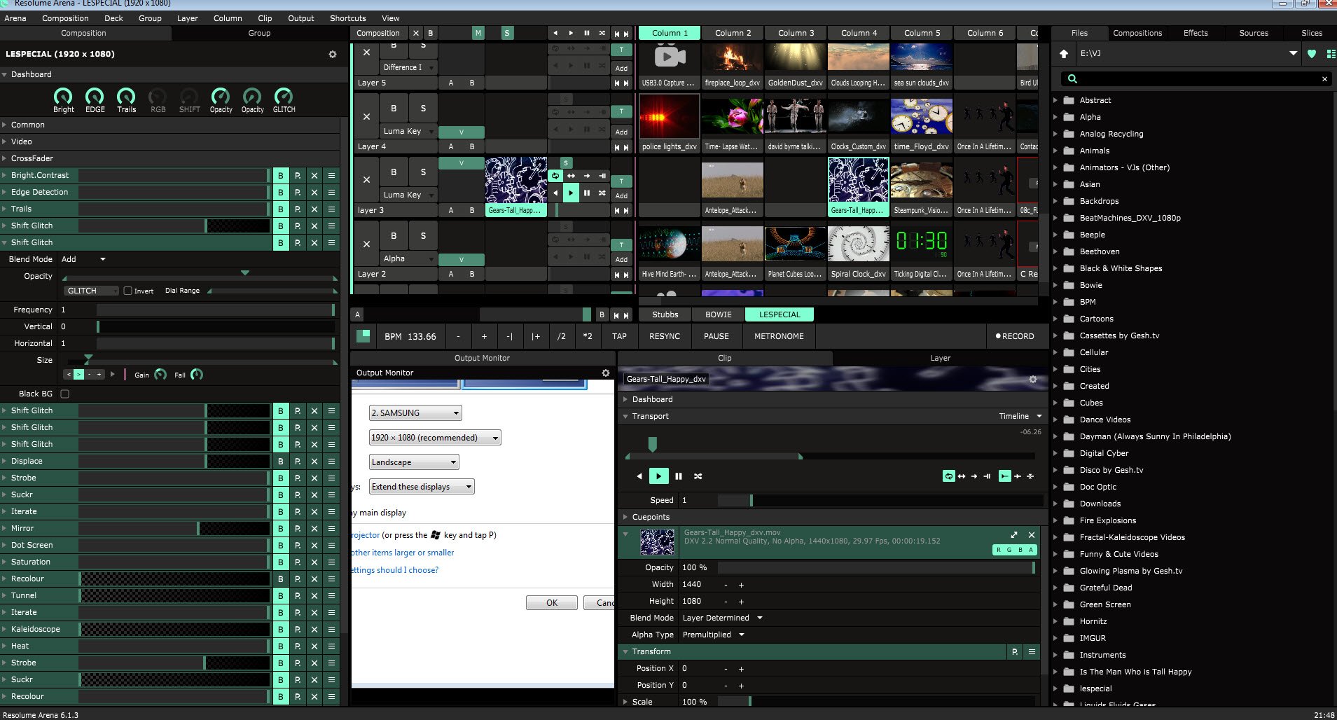

Actually, after I started using resolume again, everything works fine until...
Until I plug in an actual output via hdmi or displayport
I tried multiple different devices (projectors, 1080p TV etc)
When I plug it in the output, preview and advanced window no longer works.
I attached an image of what I am dealing with

Re: Resolume 6.1.3 Can't view h264 MOV or PNG's
Could you send us the log file again?
