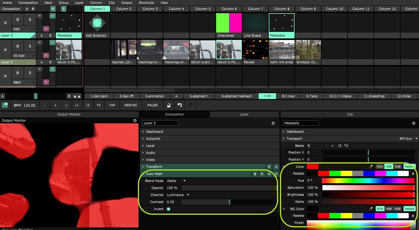

I tried the Metaballs Source in the top layer, with Balls color = red and background color = black. Using an inverted auto mask, the metaballs background created a black frame, but the visible part of layer 2 (where the balls are) is now red.
I'd rather have "tranparent metaballs".. but when I turn off auto mask and reduce the alpha of the red color of the metaballs to zero, the output is just black.
I would expect the red color to be transparent with alpha=0, not to be black? Confusing.

If you set the Color to transparent, then you'll see the background, which is black in your case.
Try setting the layer to Masking all below, and instead of Red Color in the metaballs, use White. An you don't need the auto mask in this case.

ah, the mask all below approach is much better! thank you!
