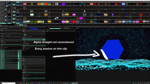

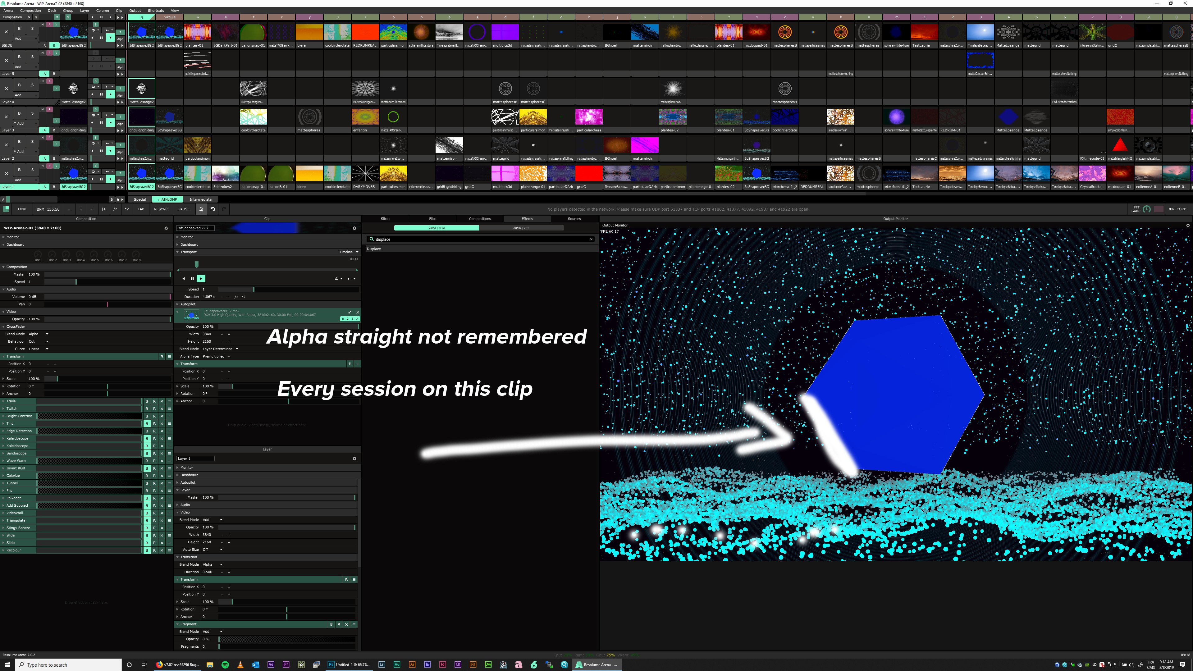

-The clips aren't remembering difference between premultiplied and straight alpha trough sessions even though I hit ctrl+s (most annoying situation is to start back at every session and lots of clicks...)

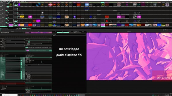

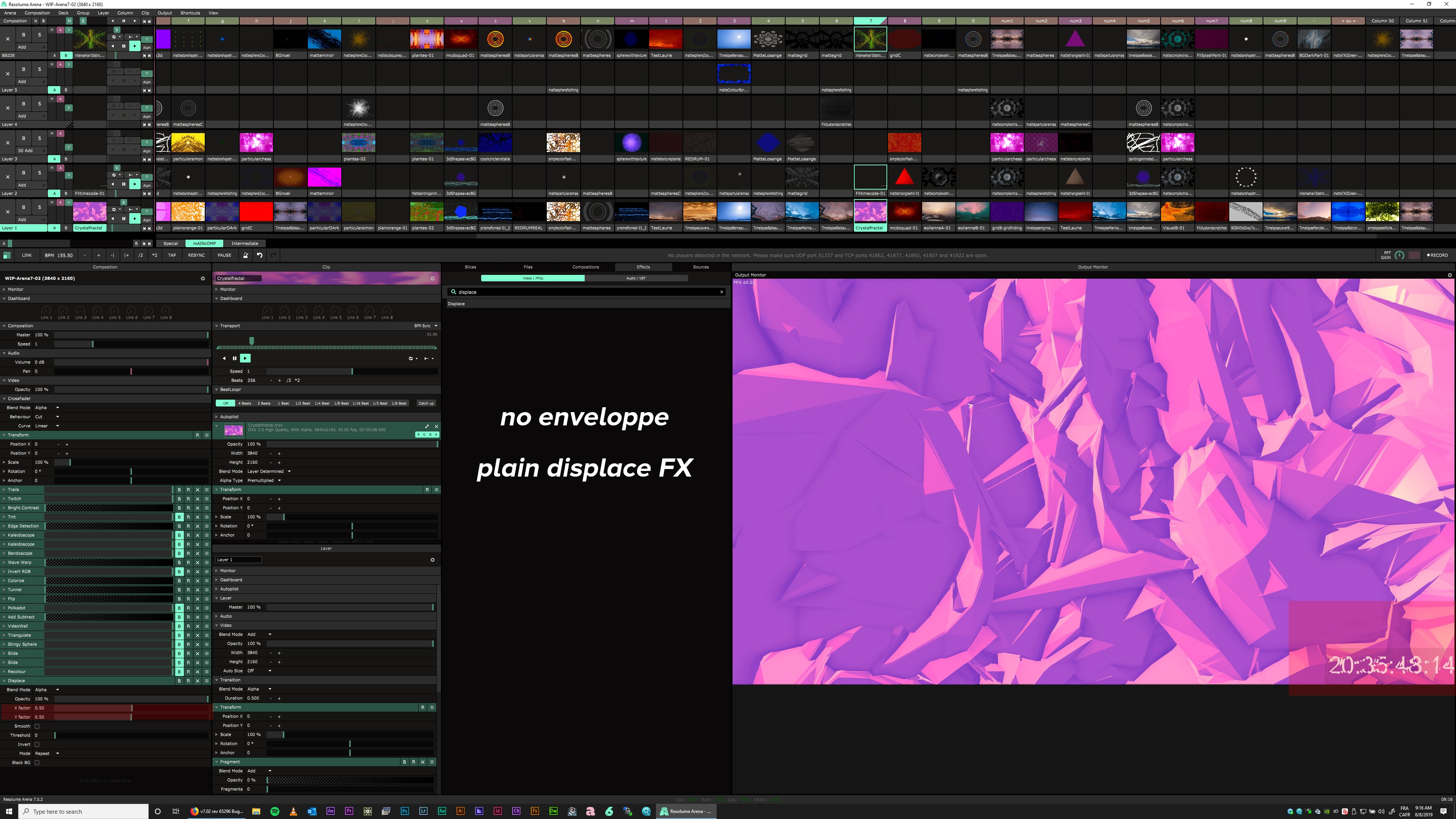

-Displace 0.50 x and y is not centered with apc40mkII so even tough you recenter the effect on multiple layers is it still distorted. Can't remember which but also some effects works badly with midi controller and used to work great in version 6

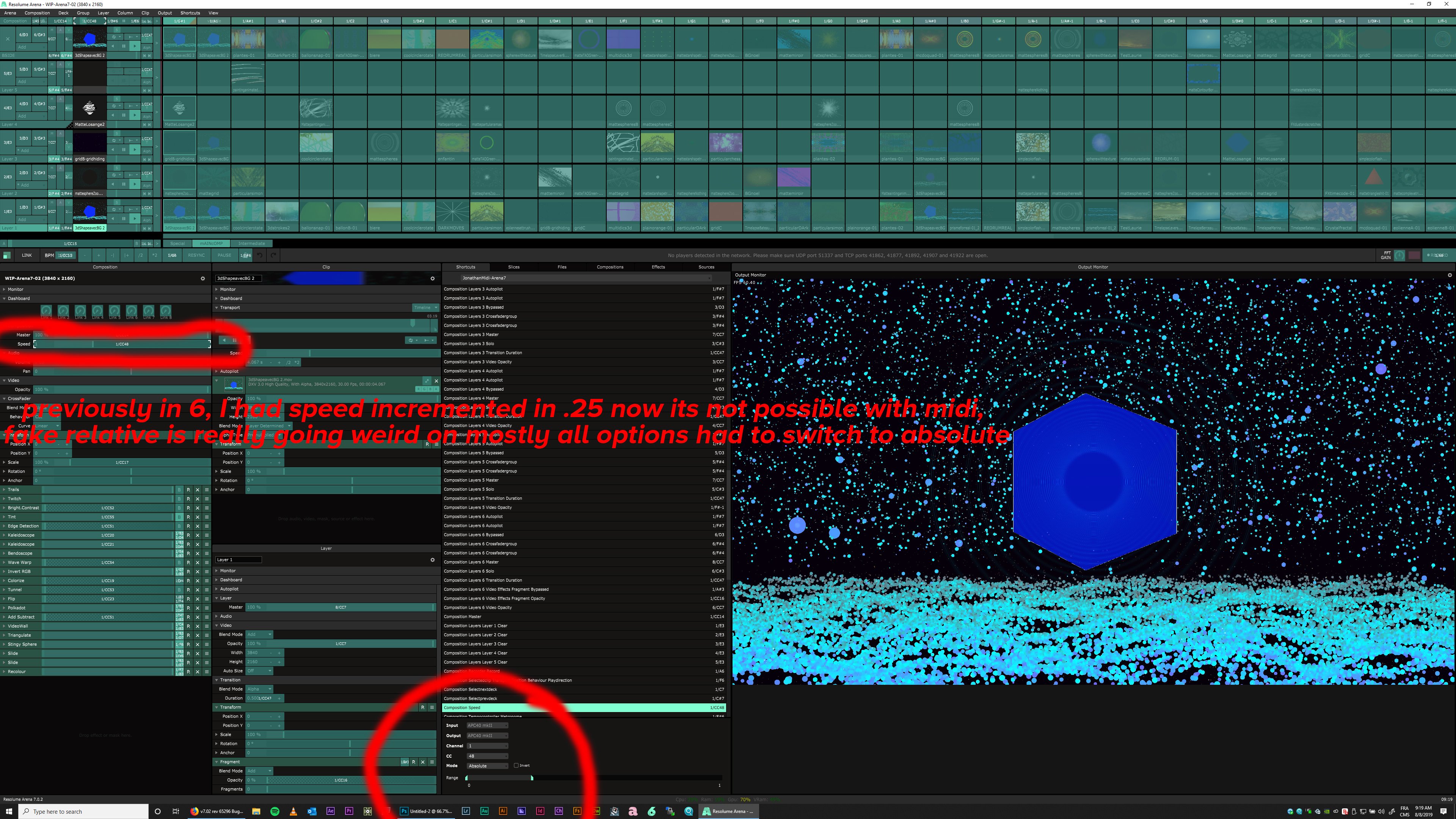

-Fake relative is working very badly with speed and many options that used to work ok in version 6

vj-01 wrote: Sat Aug 03, 2019 17:40 -The clips aren't remembering difference between premultiplied and straight alpha trough sessions even though I hit ctrl+s (most annoying situation is to start back at every session and lots of clicks...)
Thanks, made a ticket.
Displace at 0.5 y, and y is centered for me. Do you maybe have an Envelope added to the x, and y?
Could you send us a screenshot of the setting of a shortcut that doesn't work?

Thanks for the follow up, here are three printscreens !
Can't wait next version, not VJing until I have my alpha straight back ;-)
Suggestion: default import option to alpha straight (I never use premultiplied)

Fake relative is working fine for me with my APC.
You can set the step size in the shortcut directly if you want to be more precise.
With the default settings, and range set to 0-1 I get 0.01 precision at the low end and 0.02 precision on the high end. That's expected as, the speed scale is not linear.
In the displace screenshot, you have a lot of effects enabled in the chain. Try disabling them one by one to find the one that's making the distortion.
If you still see it after disabling every effect, check the layer and the clip too.
