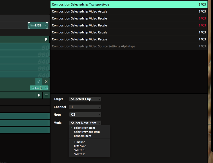

adrianmik wrote: Wed Jun 20, 2018 13:14 Is there a way to map the transport mode to a midi controller?
Yes, you can map the Transport type to Midi.
