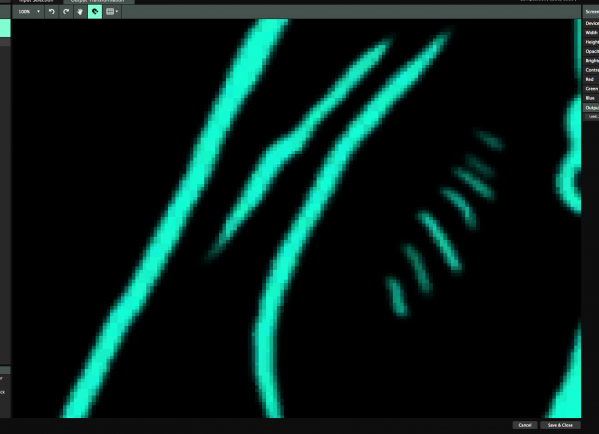

240x200px slice scaled up to 1080p:
tri-linear:
nearest neighbor:

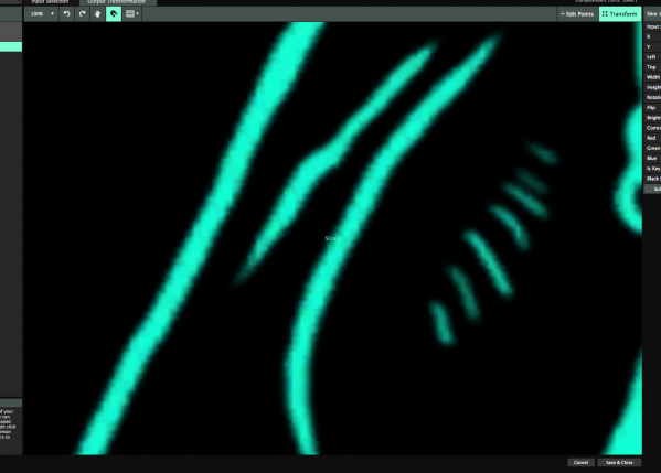

Could you post a screenshot of how the slice transform effect is set up?Zyper wrote: Tue Mar 17, 2020 17:40 Without slice transform quality is perfect.
With slice transform (who doesn't scale anythin) I'm loosing quality.

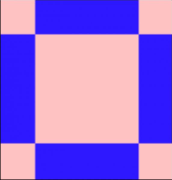

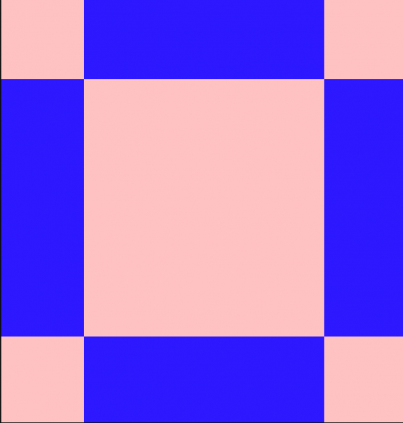

There does not seem to be a lot of recent info on this so I guess I am re-opening this topic somewhat. I have an LED surface that I want to send pixel-accurate video to. The LED is 896px * 840px, so I created a new Screen with this exact resolution and sent some video to it, but everything is getting a ~1px filter applied to it despite no scaling being applied anywhere. See attached screenshots below of a crisp checkerboard grid input and a fuzzy filtered checkerboard output. I see mention of filter selection in earlier versions of Arena; specifically, I would like to turn on Nearest Neighbor but I cannot find where this option is in the current version of the software.
Is there a way to turn off this output filtering, or to guarantee that the input and output are identical?
