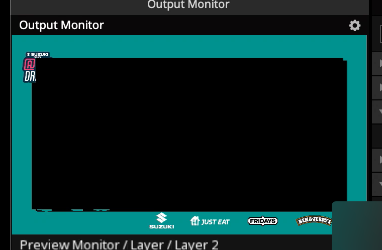

I'm using png's with alpha channel but when i click them some of the image is being cut, these images should show what i mean.If i click anything with fullscreen content it fixes the problem but obviously not what i want ! Can anyone help?

Can you link one of these to a dropbox, mega, or google drive so I can look into this? Most likely an encoder issue.

Are you playing anything in a layer above?
This looks like a black solid.

Yeah your file is fine. Here's a screenshot of it working right out of the box:
Can you create a new comp and add your file into layer 2 with that layers opacity turned all the way to full and then put a clip of something else below it?
As @Zoltan has stated, it looks like you have something played over it, like a crop FX. a black solid, or a blendmode/transition that hasn't fully finished (50% mark).
Try it out on a new comp, get it working, then try to figure out what the differences are between the 2 comps.
