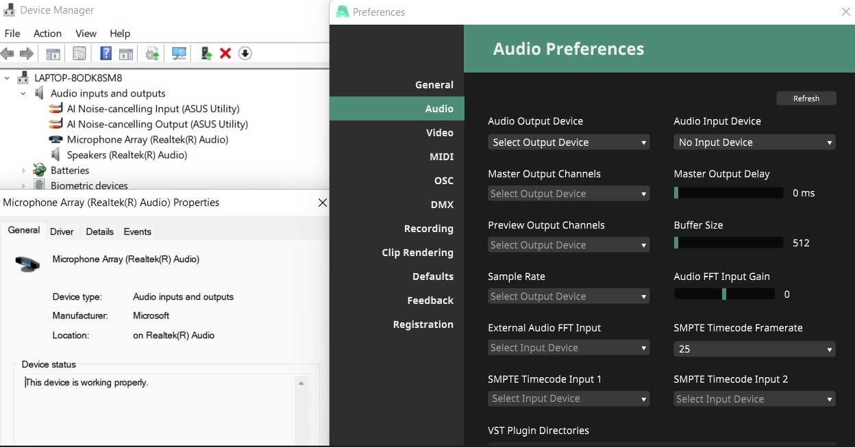

i have the same problem on my new laptop.
also Resolume is not in the list of apps that can access microphone in privacy settings.
Re: No input device
Try selecting an output device first, and also make sure both the input and output have the same sample rate set in the Device settings.
Re: No input device
it's working now. thanks
