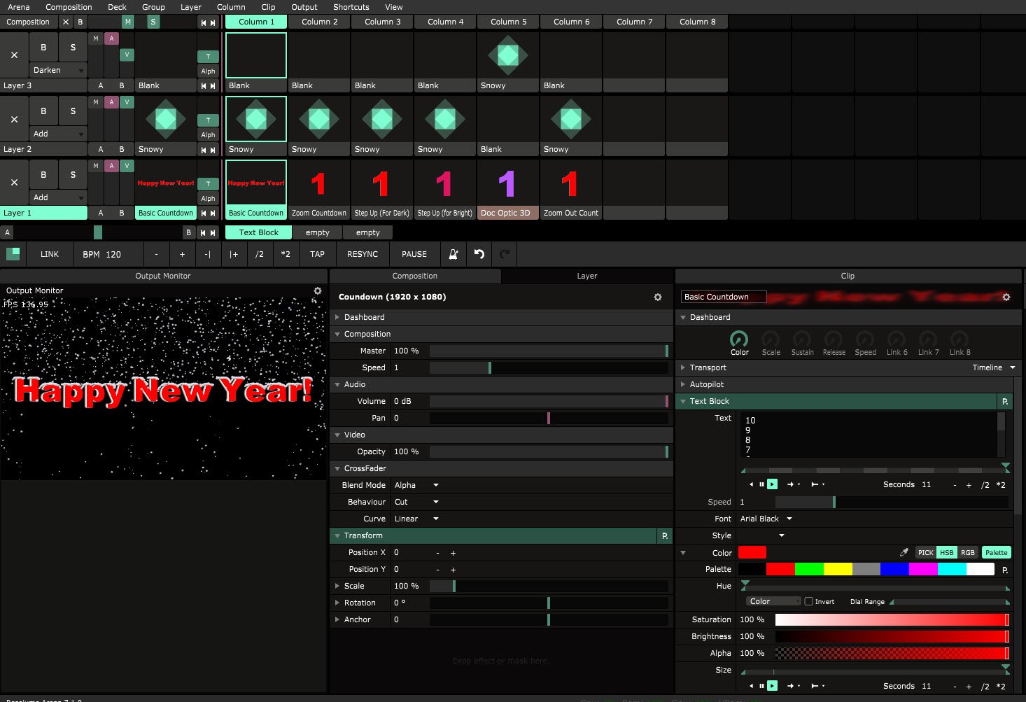

So, I loved the Countdown idea that is now possible in 7.1. Thank you Resolume! Well done! I recreated the demo clip that Resolume made so you don't have to. But that was just the start of creating other designs. I made a different Text "size" envelope where each digit zooms in. Then another where the end size amount increases, so it gets more dramatic as you get closer. Last, I added one of Doc Optic's 3D text clips, using Linear Cloner (Credit Doc Optic and link to 3D Text tutorial below). Here is the comp file.

Hello! Sorry for the delay. I am not sure I understand the question. If you download my composition file and open it in Resolume, you will see that the countdowns are already laid out for you. Noting to figure out and a bunch of different designs to choose from and modify.
Just click on one of the clips with 10 seconds left to midnight. There will be a digit change every second, with a pause on the final "Happy New Year" you can change that part to say anything by editing the Text Block effect. Just scroll to the bottom of the Text Block window.
The main warning I will give you is that my animations are based off of 11 lines of text. So my animations will be wrong if you change the amount of lines.

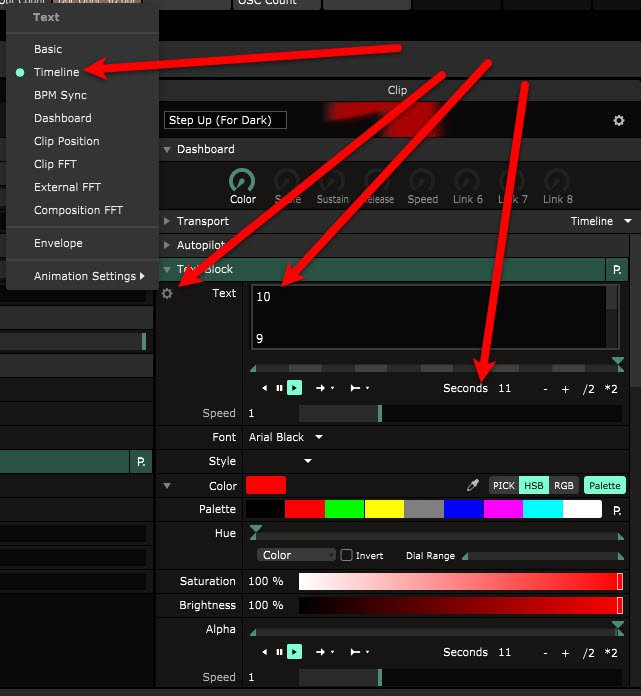

If it is a question of how is this possible with Text Block. Just type out each line (can be anything). Then set the Text Block itself to Timeline playback.
Now set your duration time. Here my duration time is 11 seconds because I have 11 text lines to flip through. A 10 second count, and then a final greeting message. 11 layers, each triggered in 1 second = 11 seconds.
You will probably want the timeline end to either stop and pause or stop and clear so the countdown does not repeat over and over if you don't shut it off in time.

hmmm ive added lines form 30 down . adjusted steps to be 31 but I'm getting the double digits form 31 to 10 playing half speed then the ones form 9-0 going very fast. whats going on do you think?
DHoude
Posts: 232
Location: Manchester, CT, USA
Re: Resolume 7 Text Block Countdown Comp
Post by DHoude »
Ok, I got this too. Originally I left spaces between each line, in the 10-second count.
When I added the 30 to 11 counts, at some point the 10 to 1 count lines had the gaps between the line removed. So that could be the issue. I can't remember why I did that, might be for the fades or zoom steps I made.
I guess just make sure that all lines have a gap between them or no gap between them. Once I removed the gaps, it played though at the same speed.
