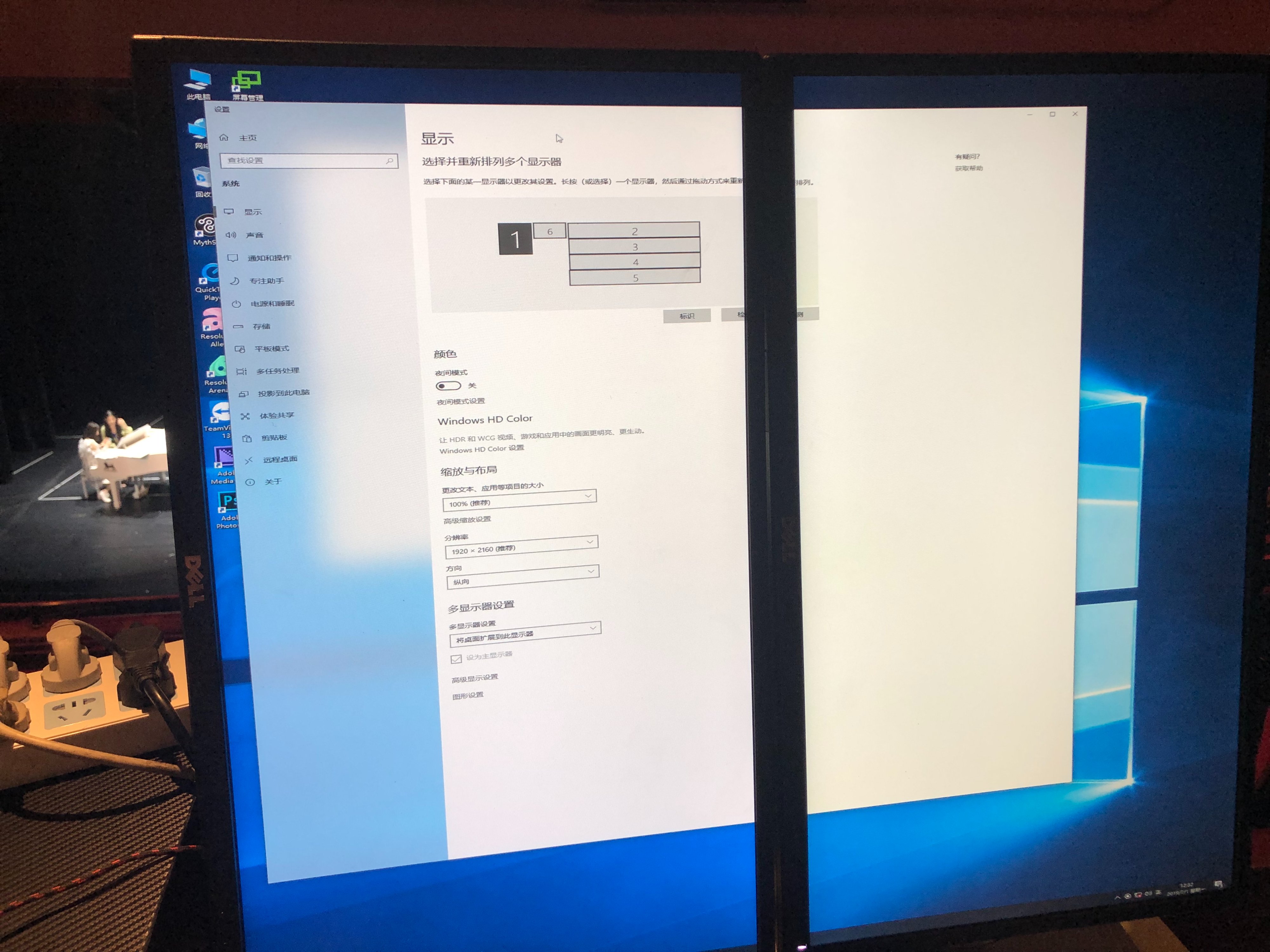

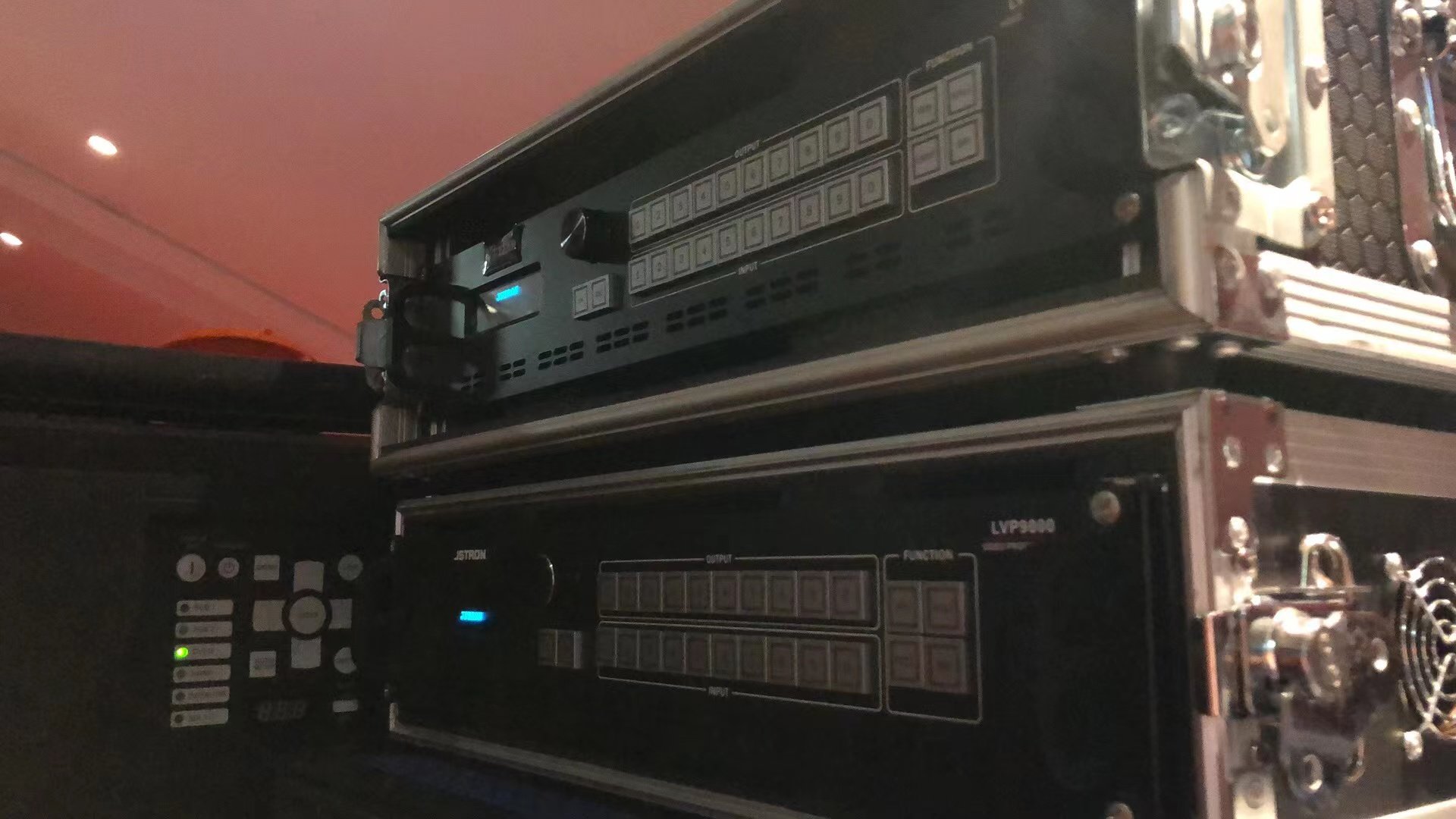

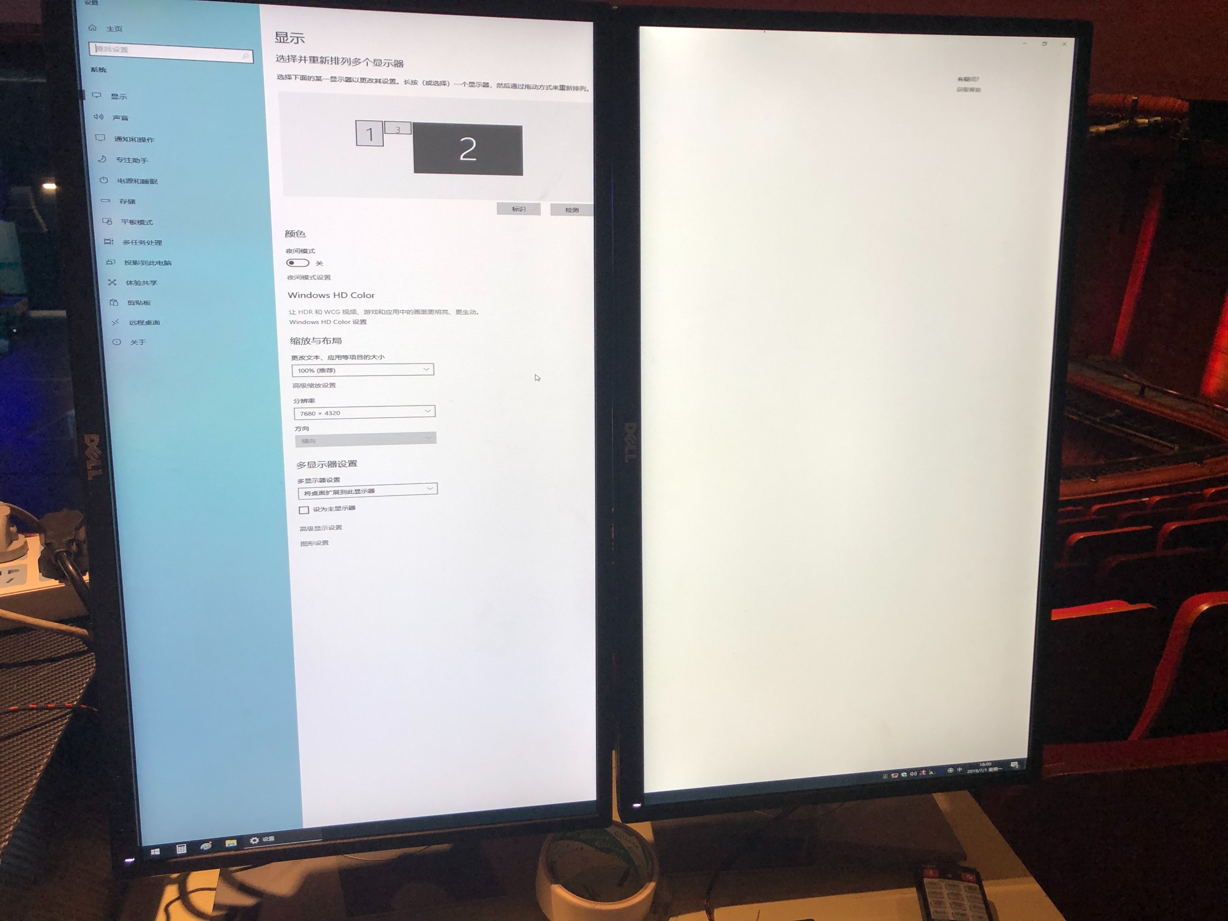

I used two JSTRON LVP-9000,cannect 17 1920 :lol: :lol: :lol:
