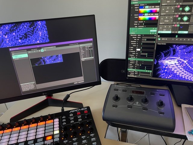

Im comping the bottom panels of a LED table for a client and am using a 1920/1080 composition but only need a 1200/300 slice of it.
Whats is the best practice to video record or render my advanced output setup (1monitor1slice) in resolume 7 while maintaining 1920/1080 composition size ?

https://resolume.com/support/en/recording
You can just record your comp output ?
Slice Transoform on the comp lvl as final effect you may need as well =)

thats exacly what i was looking for
Did not know that i could drag slices to make the composition trasnform this way :o
