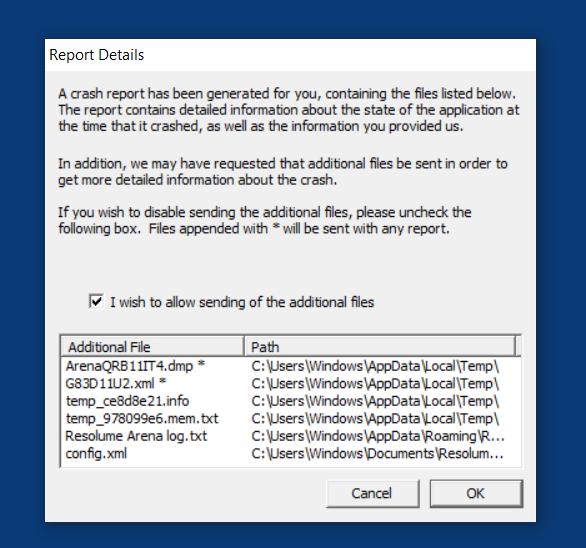

Yesterday, after updating Wire, I tried to open Arena 7.5.0 rev 77960 but it did not open and a Crash Report dialog box appeared which I then forwarded to Resolume (see below). Resolume Arena had been opening normally until yesterday since installing earlier this year.
Windows 10 is up to date, are there any suggestions as to what to do next? thanks.
System details are below

- Attachments
- 2021-10-29 (2).png (162.36 KiB) Viewed 4554 times

No need to post
Just send in that bug splat and include your name and email and someone will get back to you shortly

Re: Resolume 7.5.0 rev 77960 suddenly wont open
Updating Wire separately will break the older Resolume 7 version on the machine, because they share libraries.
We're working on making separate versions to be able to work on the same machine.
Please update Wire, Alley, and Arena/Avenue together with the combined installer from our download page.
Many thanks to Arvol and Zoltan for responding to my problem. I have re-installed from Downloads as suggested by Zoltan and all is well again
