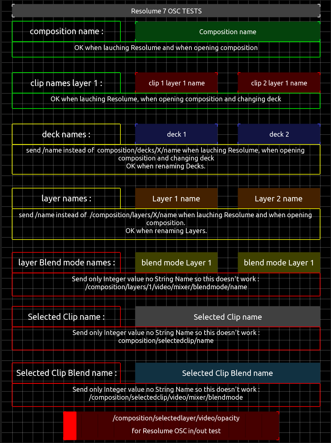

Do you have Touchosc Mk2 for test please?
I can send you a template I made to explain my different problems with osc output from Resolume.

I'll try to learn scripting to transform value to name :
0= 50 Add
1= 50 Burn
59= Zoom Out
And other good thing for me will be to translate through scripting some values like :
X*1000 = display (for Scale % for example)
or
X*120 = display (for Rotation Angle)
and many more
If you can have a look to this layout you will understand what I mean :
RES7 PROD TOOLS02.tosc.zip
(74.7 KiB) Downloaded 1203 times
Thanks again,
All the best

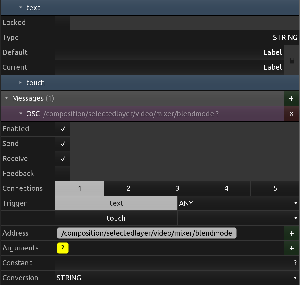

I know that I can send the name directly but :
- Using buttons in Touchosc with a blend name for each works but the button doesn't stay on when selecting a blend. So I've chosen Radio button which keep the selected blend "ON" while the others are "OFF". So I can only send Int value with this method. That's why I need to display the selected blend name.
- I don't understand how to make my label displaying the blend name with ? as String. And I don't understand where can I display the name with a button sending :
/composition/selectedlayer/video/mixer/blendmode/? (my first post of this topic)
:oops:
What's wrong in my Label parameters please?

inzieye wrote: Tue Dec 21, 2021 11:50 don't understand how to make my label displaying the blend name with ? as String
That's not possible currently, hence the ticket.
