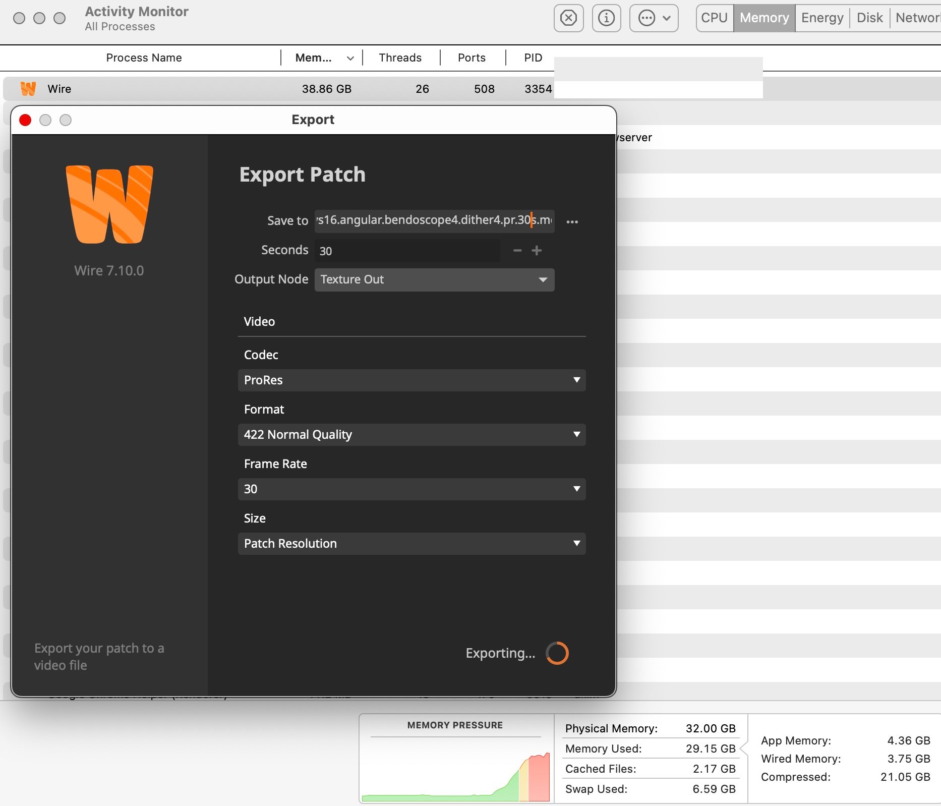

Since reporting this, I've since determined that there may be a memory issue when exporting to ProRes from Wire 7.10.0.12509. I've emailed details and log files and an example patch. The memory on exporting from Wire multiple times to ProRes from a 4K patch with random gradients grew to over 84 GB (on a 32 GB machine). This might be what I am seeing.
Since reporting, I've been using only Wire without Alley running. (What I might have been seeing with Alley+Wire is just the straw that broke the camels back.)

@Zoltán. Attachment shows massive memory usage over 38GB on export of a 4K random gradient patch (16 bpc) from Wire on a 32GB machine, during the export.
[EDIT: Won't add further attachments, but that memory stays consumed even after the export completes, and after closing the Export dialog, it is only recovered when Wire is fully closed.]

Posts: 7697
Re: During exporting Wire does not like Alley being used for conversions
Hmm, that looks like a memory leak.
We'll see what we can do.
