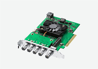

Every system should be equipped with a nice RTX card as rendercard for Resolume. Then you also have to add something like the Blackmagic DeckLink 8K Pro to every system.
4 Pc's with 4 SDI Out each = 12 SDI Outs... so to get on 15 SDI outputs you might add another card....but I have no experience if that is even possible.
https://www.blackmagicdesign.com/de/pro ... s/W-DLK-34

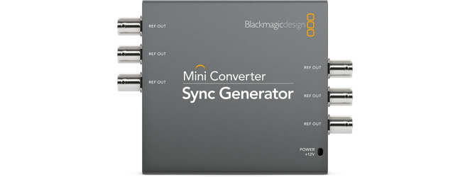

You can use 4 SDI ports as outputs. The fifth sdi port is a Ref in. There you need to send your GenLock clock in - generated from for example by a Blackmagic Sync Generator. You might see that nowhere UHD is mentioned on the BM Page....but with a Tri Level Sync you can also sync 4K Outputs.
https://www.blackmagicdesign.com/de/pro ... /W-CONM-15
