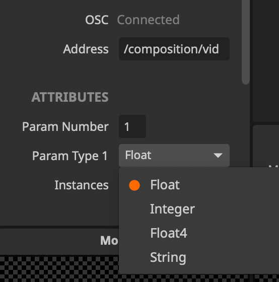

Is there a way to pass an array to Wire over OSC in a single message?
Re: Synchronize multiple OSC data streams
yes, you can set the data you're looking for in the OSC read node:
- Attachments
- Képernyőfotó 2022-07-15 - 15.30.00.png (46.15 KiB) Viewed 2566 times
