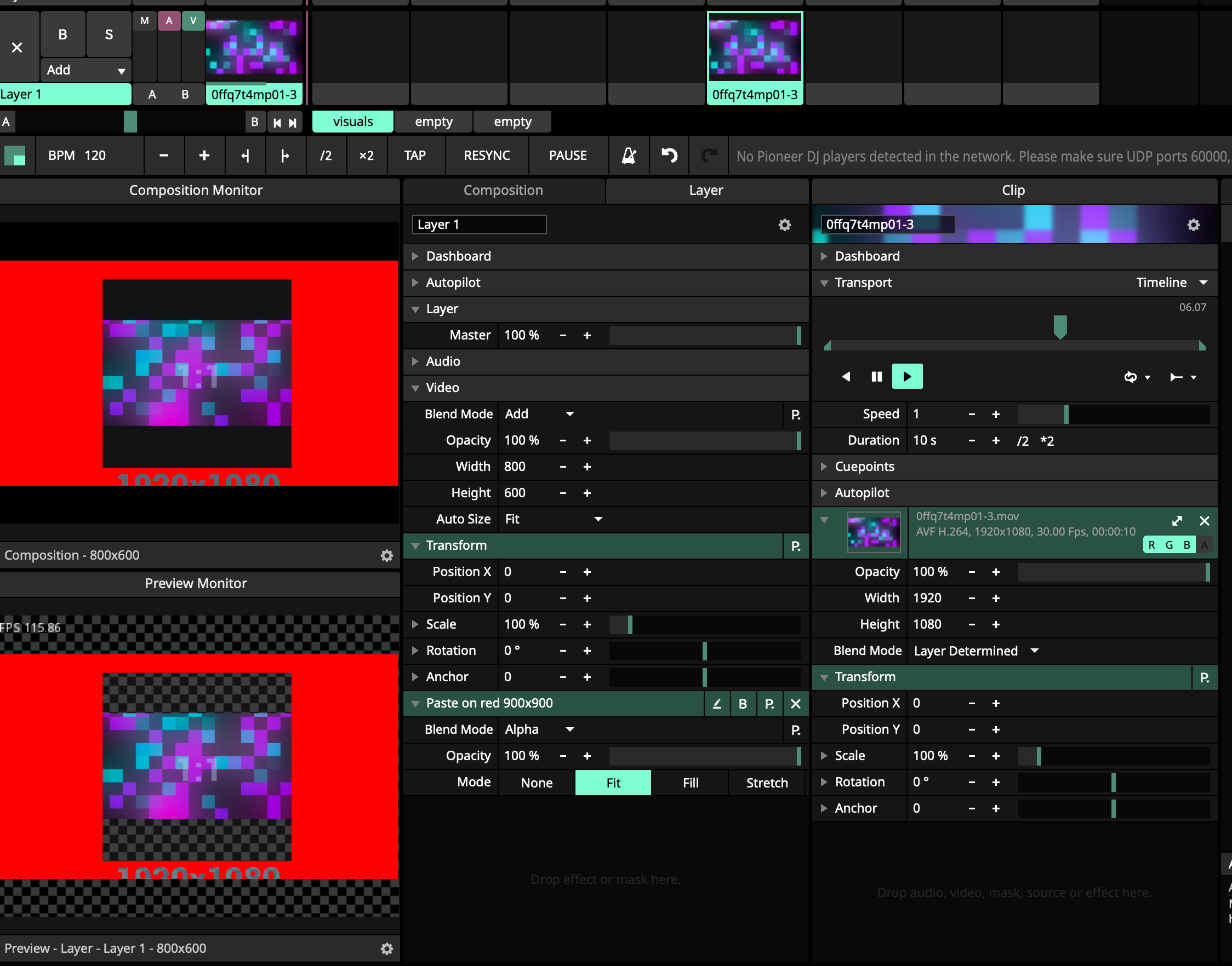

cosmowe wrote: Wed Aug 10, 2022 19:48 But when the composition resolution for example is 800x600...the frame is out of bounce ;)
That's then smaller than the output of 1920x1080 you wanted, right?

Zoltán wrote: Thu Aug 11, 2022 08:14 That's then smaller than the output of 1920x1080 you wanted, right?
I don't defined an output resolution....do you mean the big red frame at the bottom of my explanation image? There I just defined the size of the png itself.
Using also smaller resolutions and fit the frame including scaled contend was part of my "I don't know how" :mrgreen:
