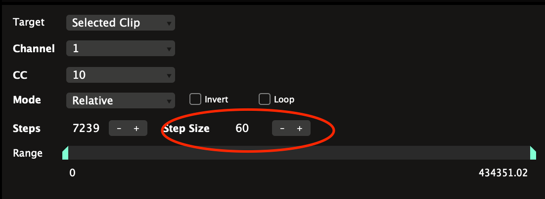

Hello all,
i'm using resolume in a special context ; trying to emulate a replay machine, with a MIDI controler i built
Everything works fine ; t-bar for speed from 0 tp 100%, payback, reverse etc...
My question here is, it is possible to have a FIXED step size . I want to have a step size of 60, no matter what the length of the file.
I know that by default, its the other way around; the STEPS are FIXED and the step size adapts.
Any ideas?
Thanks

Thanks, but that's not what im looking for.
for now, i'm using a imported file. I want the transport head to act as a replay machine would ; each "click" of the rotary encoder would move the play head the same STEP SIZE , no matter the file size

hmm, moving this to feature requests ;)
Relative OSC messages could help with this, if you can do OSC, but that seems to have a bug we need to fix first.

And there seems to be a difference in this behaviour between v6 and v7.
On v6, you can input small step sizes. but in v7, if you go lower that 120, it automaticly goes to 0
