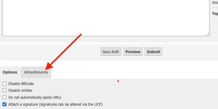

You can attach them when posting using the Attachments tab below.

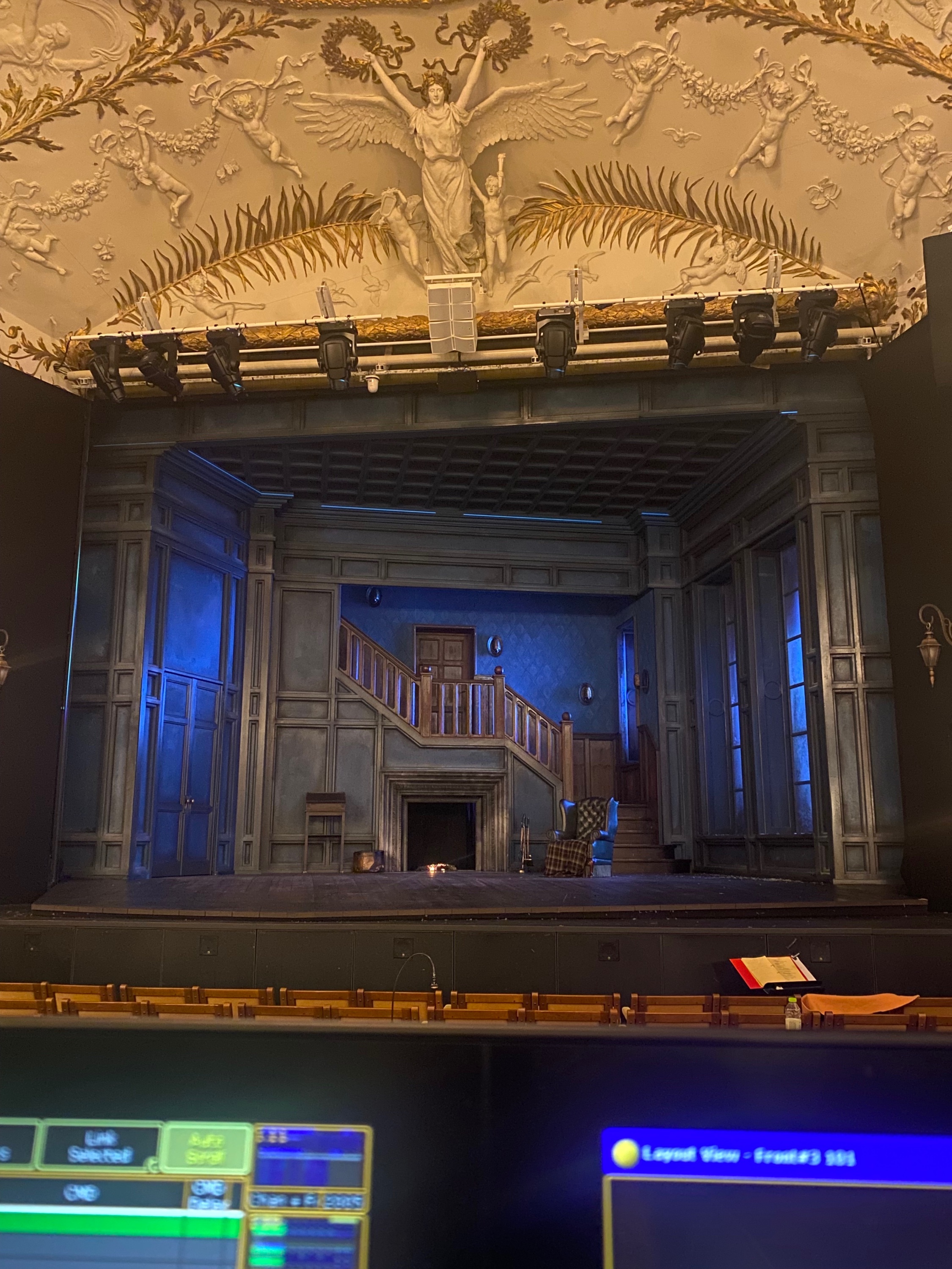

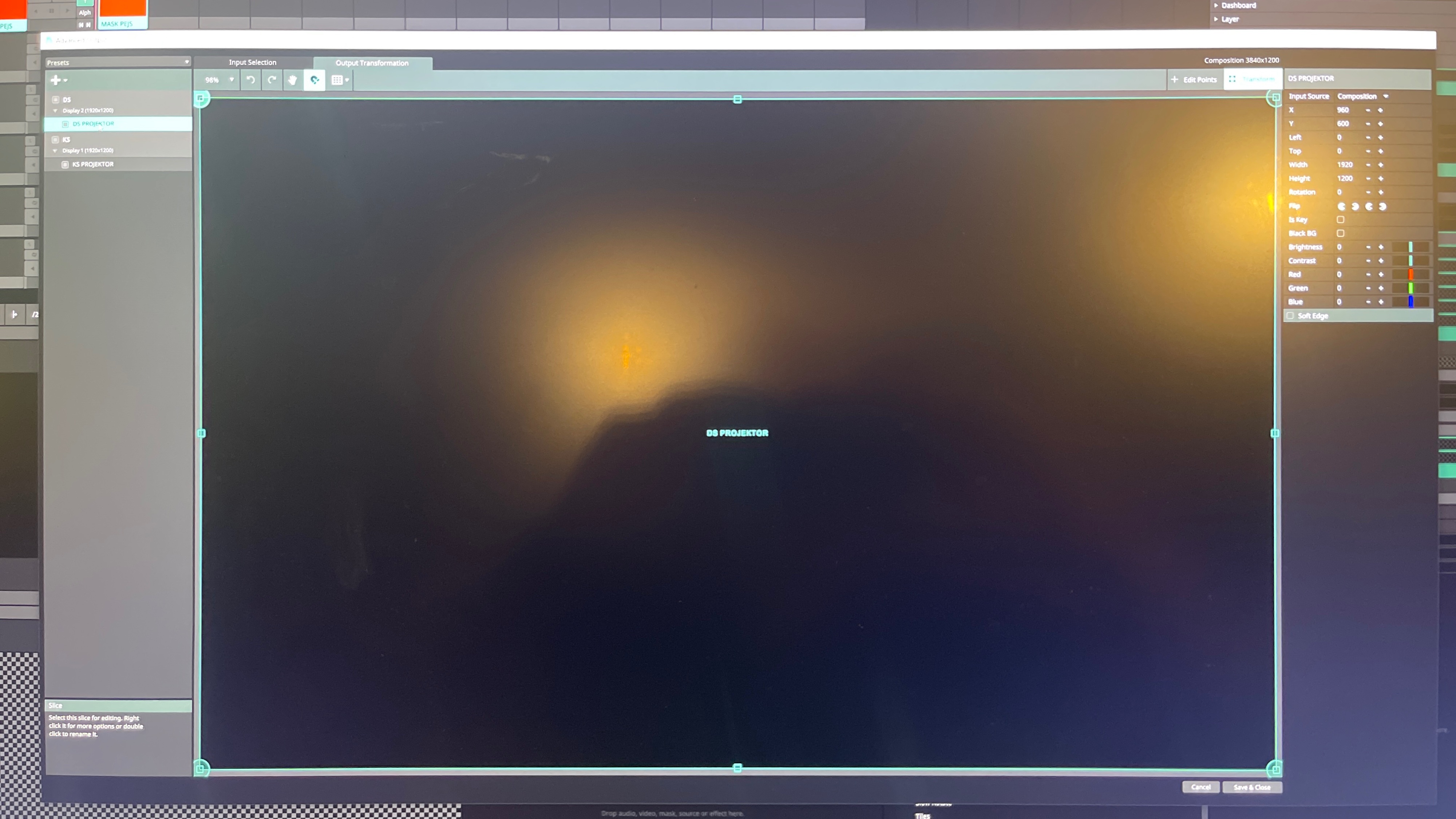

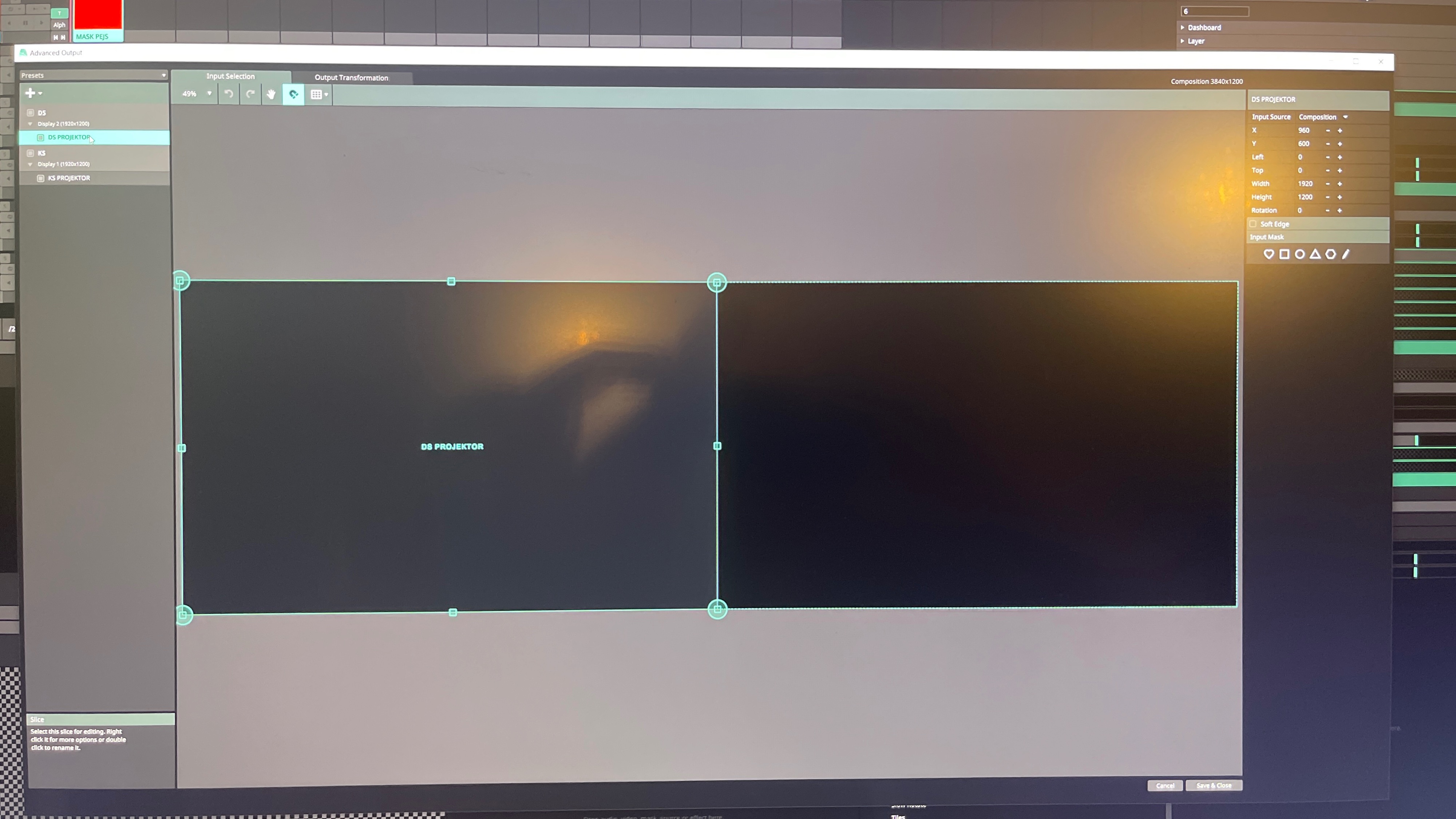

I attached picture of my stage, and the advances output.
It is only one projector making the line. it is the one in the top, about one pixel.
Have you any suggestions?
It helped to make the desktop color Black.. however it seems like a bad workaround.
