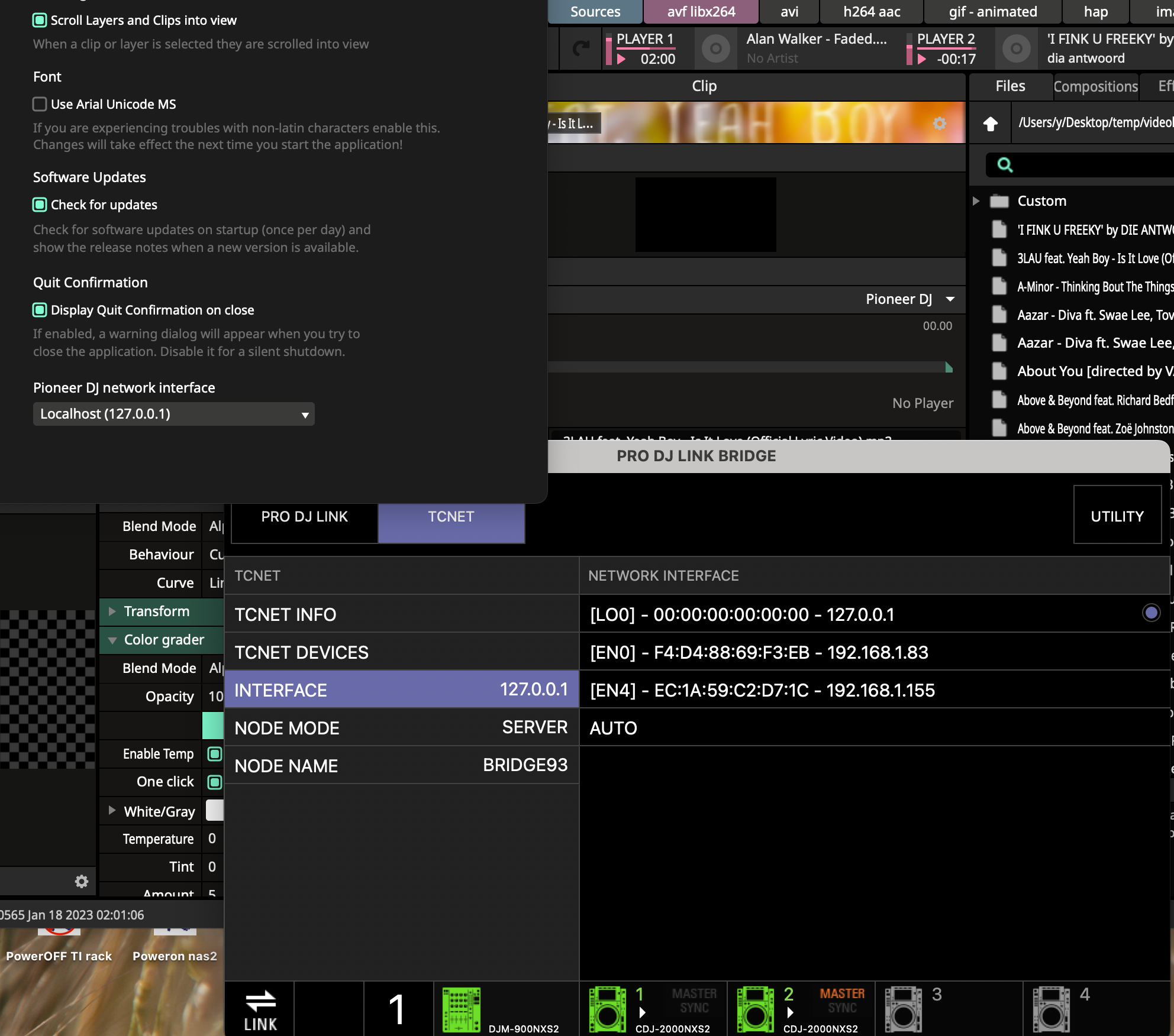

These settings work just fine for me on Ventura, 192.168.1.155 is my wired adapter

If you're on M1 mac, try running the bridge app in Intel mode, right click, properties, open using Rosetta.
Re: Pioneer ProLink Deck Target Incorrect
OK... Well, that was mostly it.  The Rosetta setting got it to connect!  Thank you.
