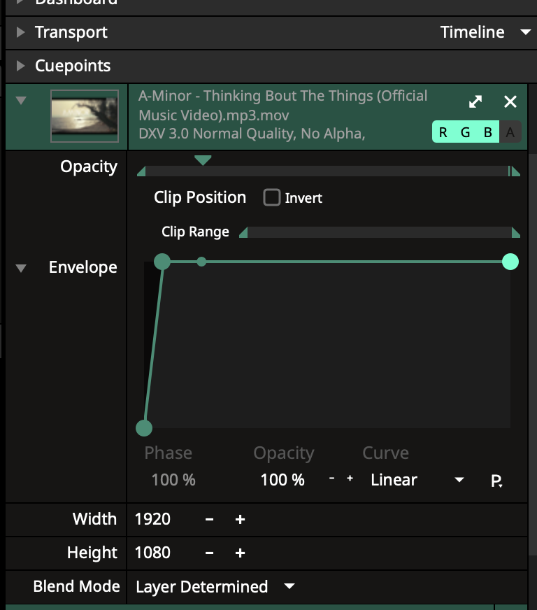

Hi!
I have been experiencing just that. I can reproduce it also:
DXV3 clip. Opacity with envelope set at "Clip Position" to make a 3 sec fade in.
Then I change decks and trigger an empty column in second deck. Then, I switch back to the deck where my clip is. When I trigger the clip, I got a frame flash. But only the first time I trigger it...then if I don´t switch decks there is no flash. This is not happening when the envelope is set to timeline. I tested it on 3 different computers, all win 10. Arena 7.14 and 7.15.
Has anyone experienced this? I suspect is a easy fixable bug. How can I report it?
¡Thanks in advance!
Cheers!
Posts: 7781
Re: Clips with opacity set to clip position envelope flash when triggered
Like this?
Interesting seems to indeed happen sometimes on windows. We'll see what we can do.

Yes! just like that!
Thanks for the reply and the confirmation.
Hopefully it will be an easy fix ;)
