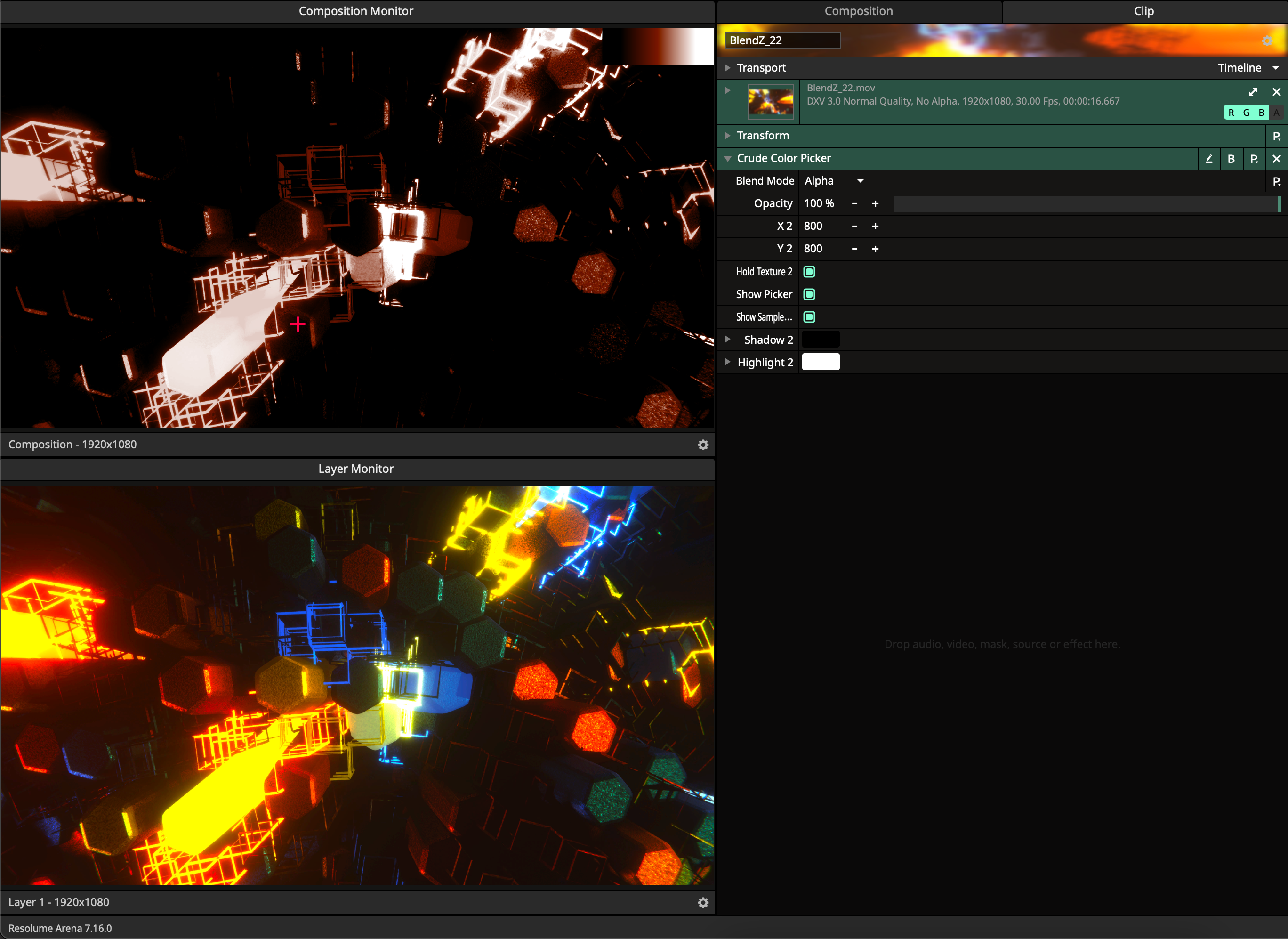

This patch(resolume 7.16) will grab a single pixel and uses it to colorize the incoming texuture.
We made this to demo how to grab a single pixel and hope this helps you on your way.
The CPU<>GPU communication is coming at some point, but for now this kind of workaround might help.
