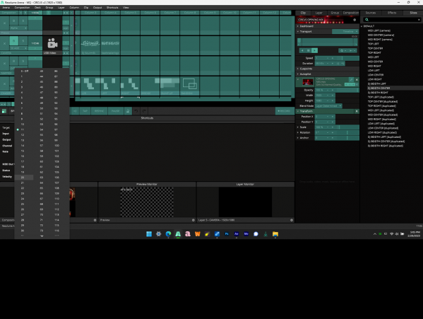

I just got an Akai APC Mini MK2. I was wondering if there was a guide for coloring the buttons or software/drivers im missing? This model has full RGB but when I edit midi in Resolume I dont get the thumbnail of the color and color names like the APC 40 MK2 does.

I have looked through this table and can't make sense of it in relation to Resolume. I've changed all the dropdown settings to everything I can think of when in midi mapping mode. Can't get any pads to light up at all, much less change the colors. I'm on 7.3 sill.Zoltán wrote: Wed Feb 22, 2023 11:03 Resolume doesn't have the APC mini color codes integrated.

I'm in the same boat. I've seen a few people mention you can pick different numbers from the velocity drop-down but that does nothing for me. I've tried setting it, saving, unplugging, and rebooting Resolume...sparksmemphis wrote: Sat Jul 22, 2023 21:44 I have looked through this table and can't make sense of it in relation to Resolume. I've changed all the dropdown settings to everything I can think of when in midi mapping mode. Can't get any pads to light up at all, much less change the colors. I'm on 7.3 sill.
