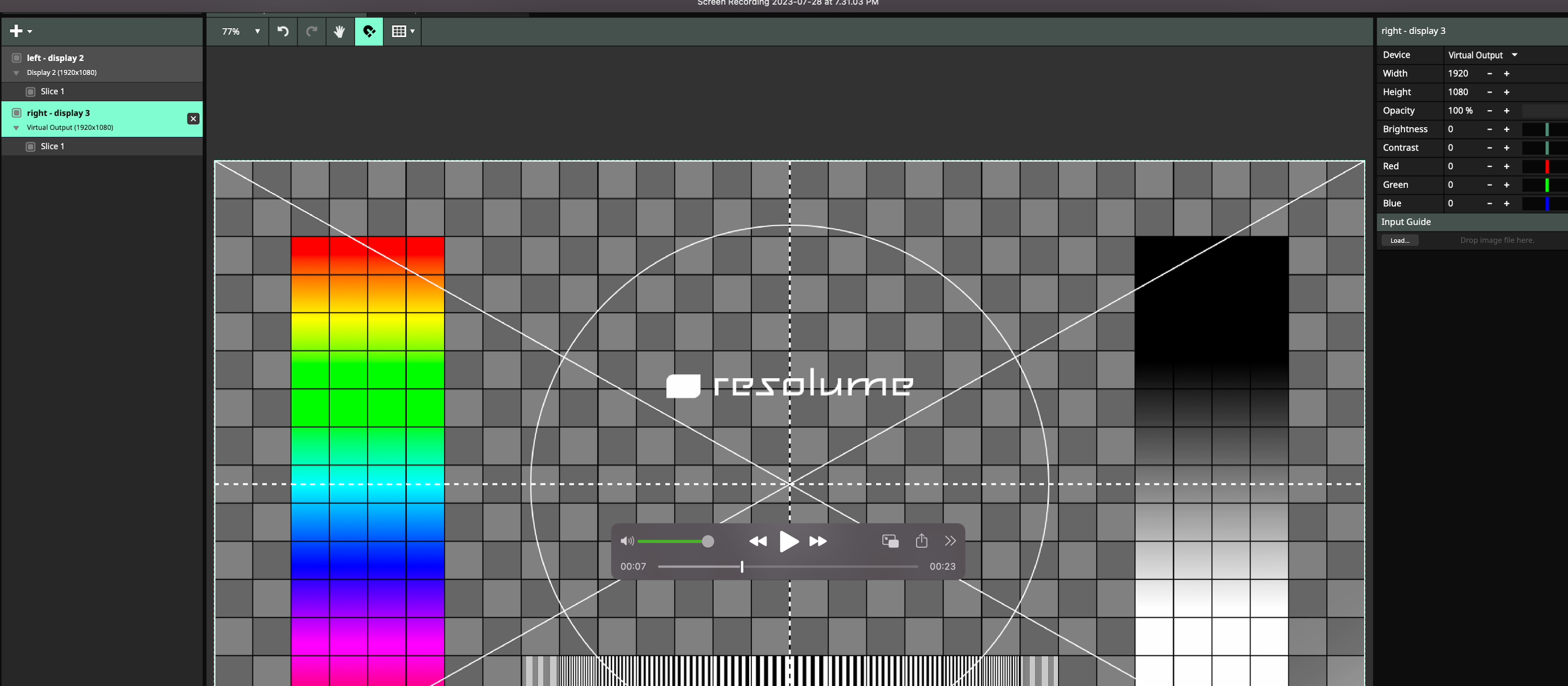

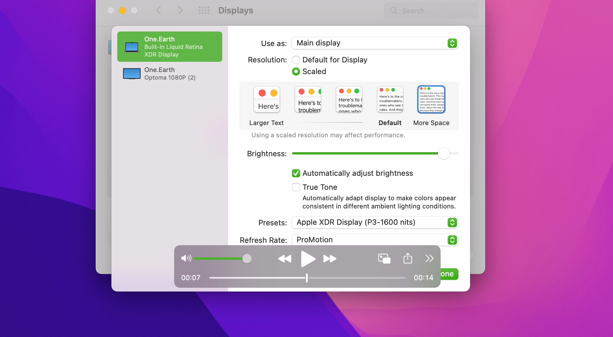

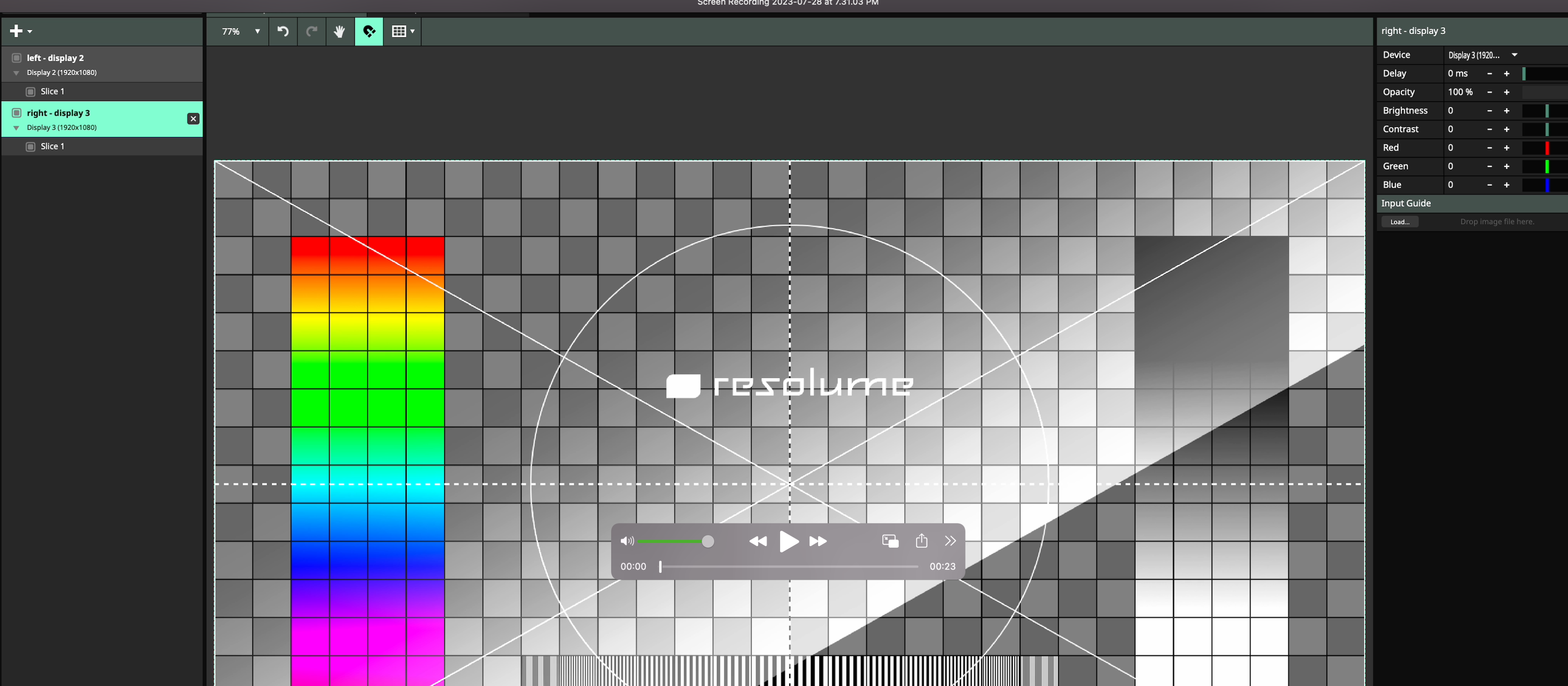

The problem is, as I try to recreate it, my system is resetting one of the EDIDs. Check my attached images. I noticed this on my Mac display settings as well. I notice a flash where one projector leaves and comes back.
This resets my Resolume advanced output for the second screen back to “virtual output”. Only one of the projectors is able to pick back up.

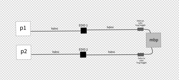

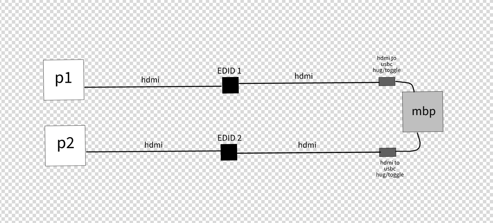

back to topic: to what outputs do you connect the two lines?

He2neg
- Check out the attached outline. I hope this can answer your question.
Thanks for the advice. This has been a great learning experience so far! :)
