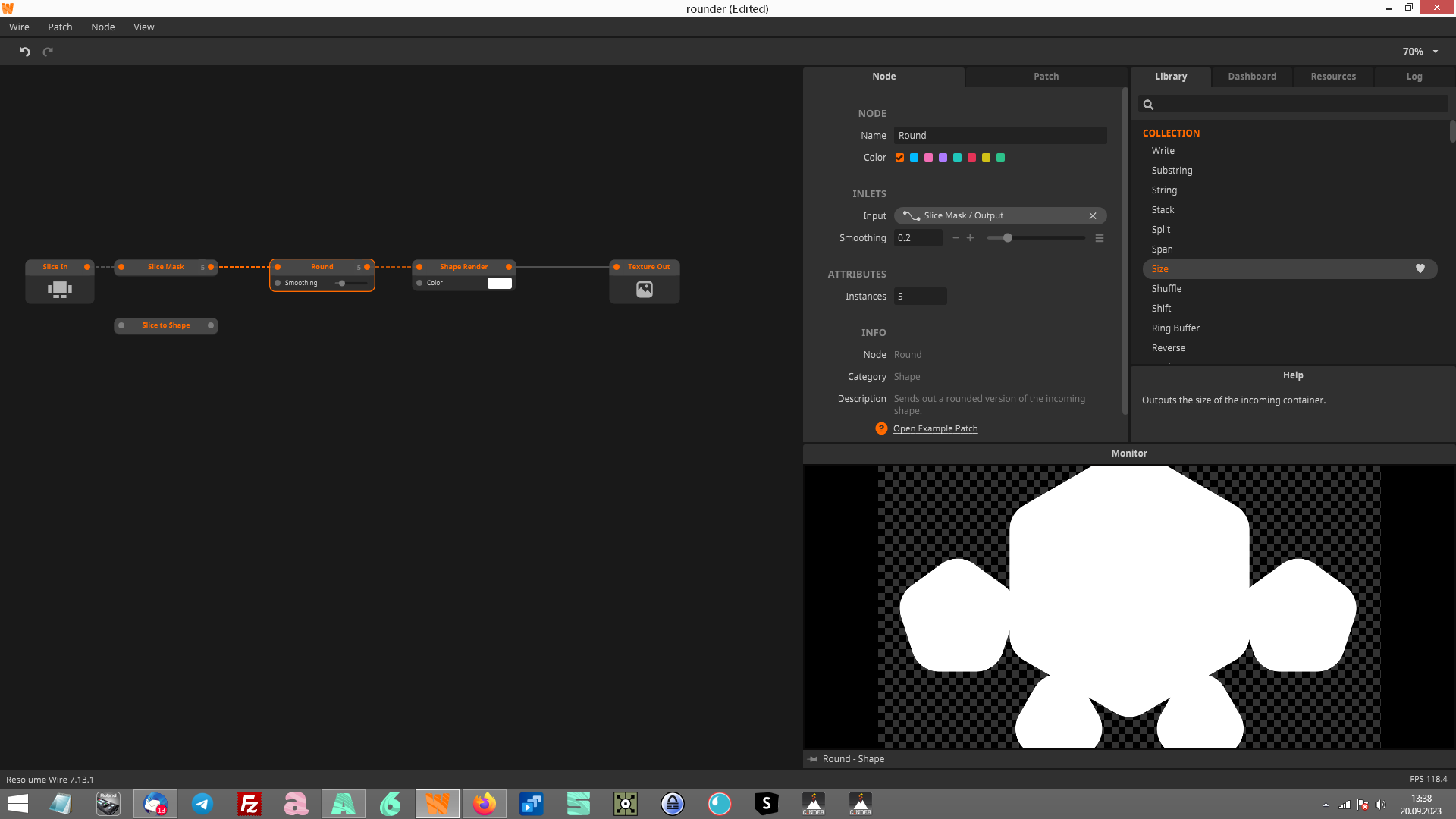

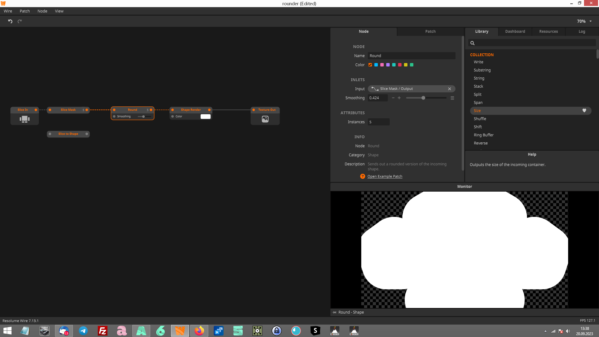

btw a little feature request for the "round"-node.
for now the round node rounds the corners of a slice to the outside. but i think it should be into the inside, because otherwise the rounded corners would be outside of the visible area of a slice in the projection.
use case for round would be for example if you'd wanna round up the hexagon to a circle

Textures inputs are rasterized images, shapes are math formulas.
Finding corners in textures would require some kind of object recognition which Wire doesn't have currently.
Slice masks are not constrained to the slice areas. If you modify the shape of a slice mask (which is a formula), you might be making bigger.
Transform can be used to make it smaller with the Scale < 1
Outside corners could be rounded with something like this:
