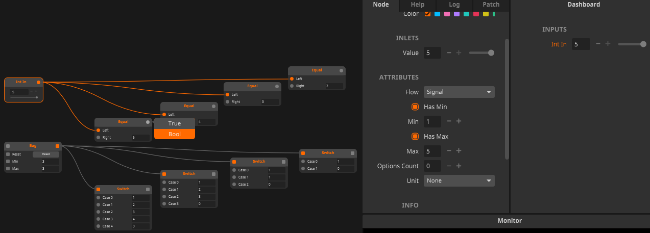

Please help me with the following Wire node connection (according to picture).
I want to pass on a Int value from a "Bag" node according to the following:
If the (user input) Int in=5, pass the int value from the Bag node ONLY to 1st switch node.
If the (user input) Int in=4, pass the int value from the Bag node ONLY to 2nd switch node.
If the (user input) Int in=3, pass the int value from the Bag node ONLY to 3rd switch node.
If the (user input) Int in=2, pass the int value from the Bag node ONLY to 4th switch node.
How can I represent this using the nodes in Wire?

It ALMOST works, the suggested solution still sends out a 0 (zero int) from 4 out of the 5 switch nodes on the right. Is it possible to have a setup that only sends out the "Bag int" from one of the 5 switch nodes (and nothing from the other switch nodes, i.e. "killing the signal" on 4 switch nodes which are false)?
If not, I think I need to divide the code, maybe routing the signal by triggering an external OSC command. This way the signal only reaches the "correct" (one out of five) switch node. Sorry for being a Wire n00b.
(It's for a complex routing inside a patch I will share on Juice Bar once it's done. I understand it would be easier to understand the underlaying problem but then I would need to take up a lot of your time to explain. I'm very thankful for the help I get for bits and pieces. :-)

What are these being connected to? The end point still needs something connected to it, so you can't just sever the connection, but you can send a value to it that would be out of range? What is it that can't take a Zer0? What would it need instead?
Try to use Gate in Event flow instead of Switch.

This is how it turned out:
