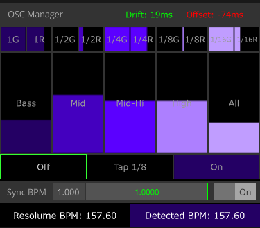

Now that Wire is a thing, I decided to take a pass at replacing the "mixing" and UI component of my VJ system (that I had originally built in TouchDesigner) with Resolume.
Since I'll be mixing external patches (TouchDesigner, tooll3, Notch, etc.) with "local" patches in Resolume (e.g. Wire), I need everything to be tightly synced. My original plan was to use Ableton Link, but I need to be able to arbitrarily resync to align phrases/phase which is not possible at the moment. I'm typically working with modular/DJ performances where the phrase will be changed at the whim of the performer (especially common after improv breakdowns).
To work around this limitation, I have a small TD patch that sends/listens to the BPM and resync events from Arena over OSC. It maintains a parallel clock and phase, sending envelops/gates to both Arena and other external patches. Listening to resync/BPM changes this way has a small amount of latency that I'd like to compensate for (usually around 1-3 frames).
I'm also making detected BPM (among other audio analysis) available and controlling Resolume's BPM when it's over a certain confidence threshold (which also causes clock/phase drift due to messaging latency).
Screenshot 2023-12-14 082338.png (26.31 KiB) Viewed 36440 times
In order to detect drift, I compare the internal timing of the triggers from the TransportTick/TransportBeat operator in Wire, with the corresponding incoming OSC events. I send that delta back to TouchDesigner and use it to calculate a clock offset to align the phase of Touchdesigner with the phase in Resolume.
