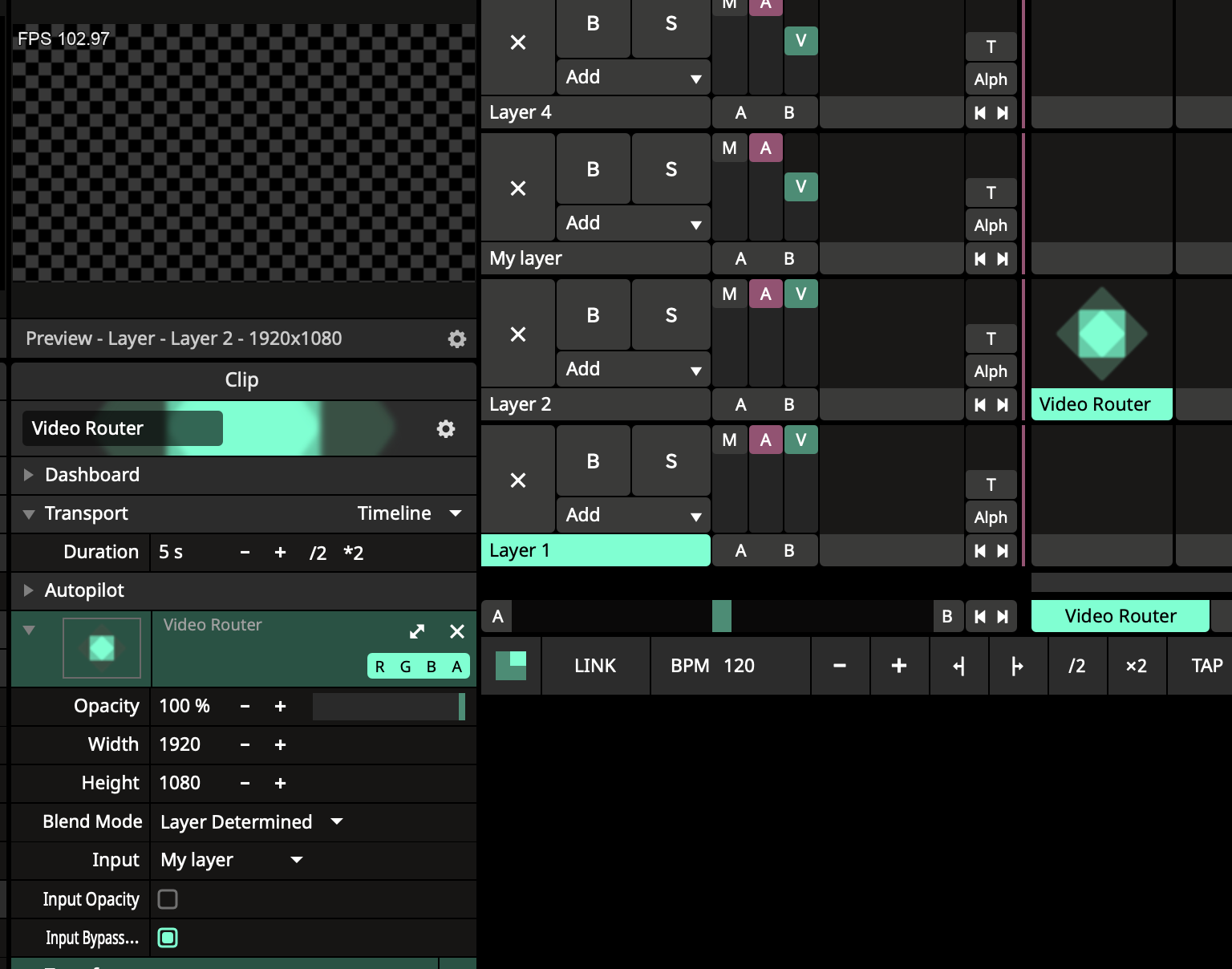

For example, here is my file before inserting a new layer: As you can see, I have selected 'My layer' as the input for the Video Router.

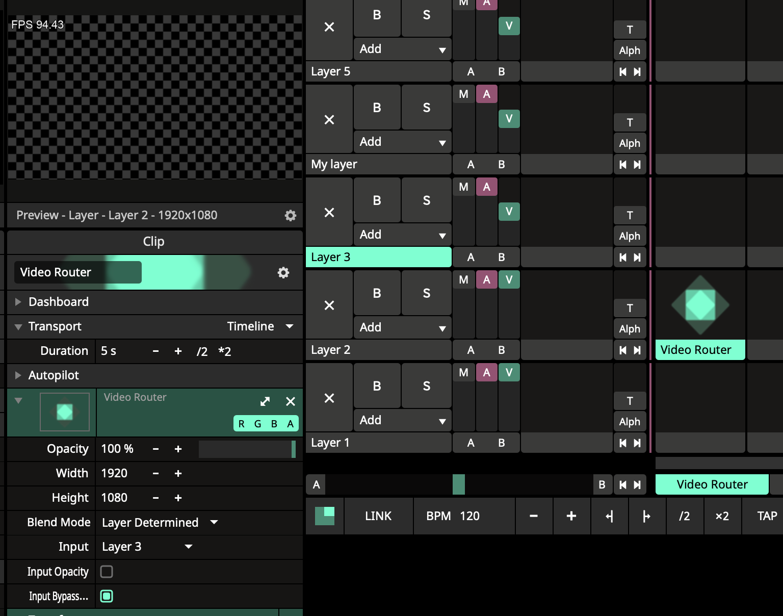

This is what happens when I insert a layer below 'My layer'
You can see that the input has changed. This is unintended behaviour and not within my power to modify, as far as I'm aware.
