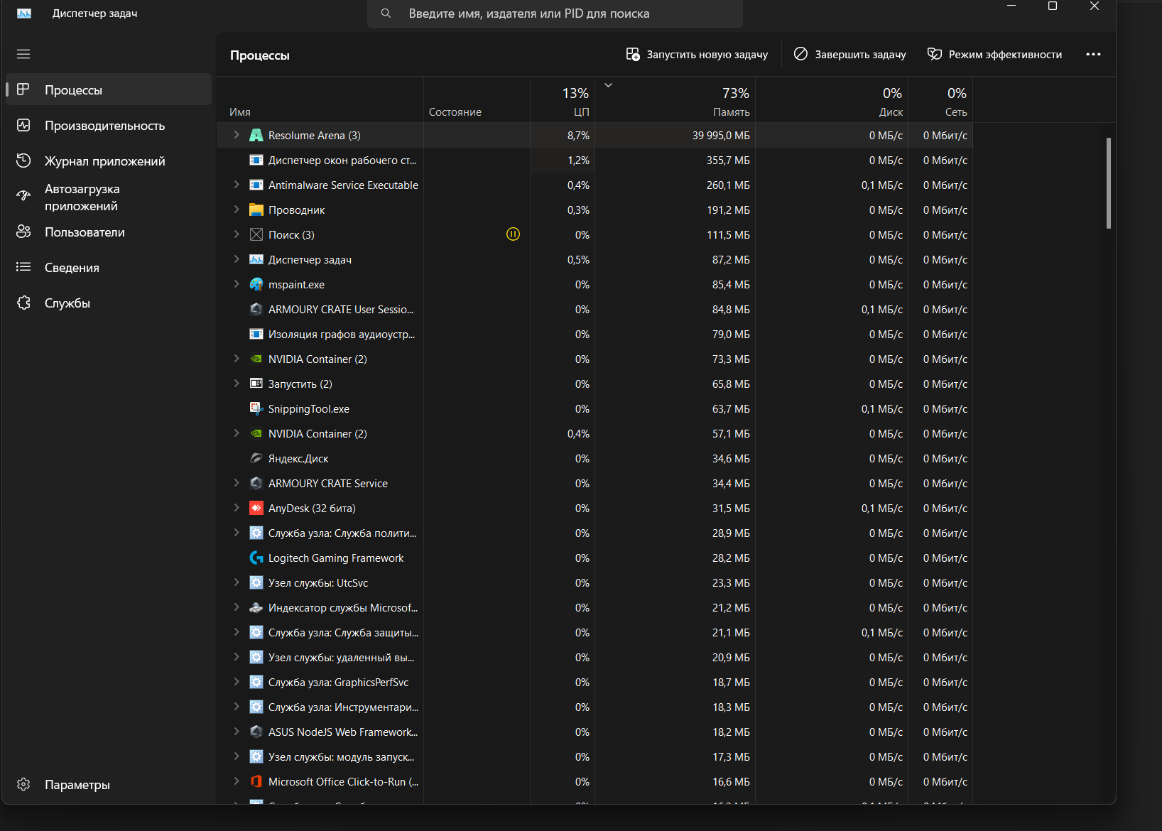

Hello! Yesterday i notice what when i activated ugreen hdmi capture device Resolume start eat memory. Its strange because what on another video capture device i dont have same problem, only on ugreen capture deivce
Attached video and screenshot with problem.
Check this capture device on another laptop with Windows 10 and Resolume 7.16.0 - dont seen memory leak.
Resolume Arena 7.19.2.33366
Windows 11 Home 23H2 (22631.3527)
ASUS ROG Strix G18 G814JI
CPU: Intel Core i9 - 13980HX
GPU: NVIDIA GeForce RTX 4070
RAM: Kingston FURY Impact [KF556S40IBK2-64]
DEVICE:
uGreen HDMI Video Capture Card (USB/Type-C) CM489 (40189) (Windows ID: USB\VID_534D&PID_2109&REV_2100&MI_00)
And it will eat all memory at the end Resolume will show error and app is fall
2024-05-07 16-34-44.zip
video with memory leak
(691.79 KiB) Downloaded 927 times

Okay, i update Resolume on my old laptop to last version on Windows 10 and can say what this problem only on Windows 11, on Windows 10 all worked well. Also i notice, what if i change capture resolution and select lower capture resolution - memory leak is stopped! Its same situation with cheap HDMI capture USB device (like cheap RULLZ devices).
