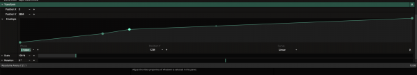

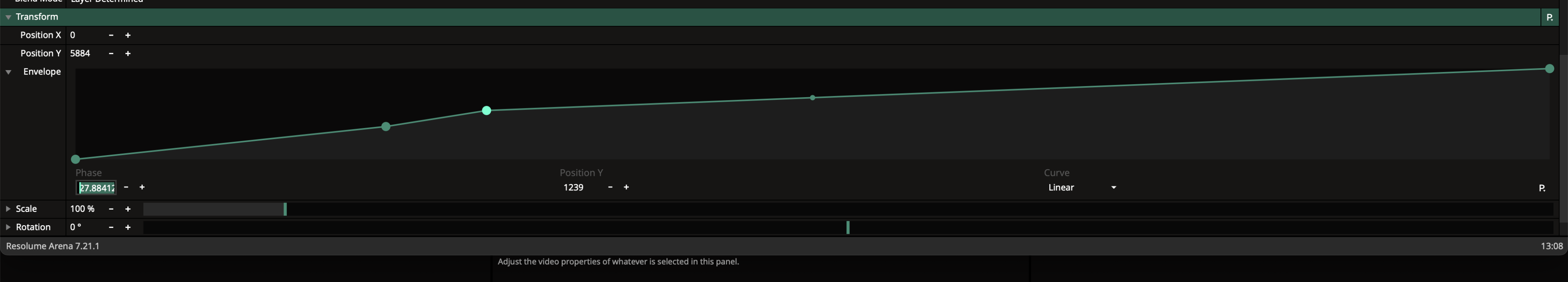

Posts: 7706
Re: Record/Edit/Playback OSC
If you undock the clip panel, you can make it really wide, so you have more room to set the envelope points.
You can also set the points by entering the Phase and position values manually.
If you animate the parameter to clip position, the envelope points will always happen at the same clip time.
