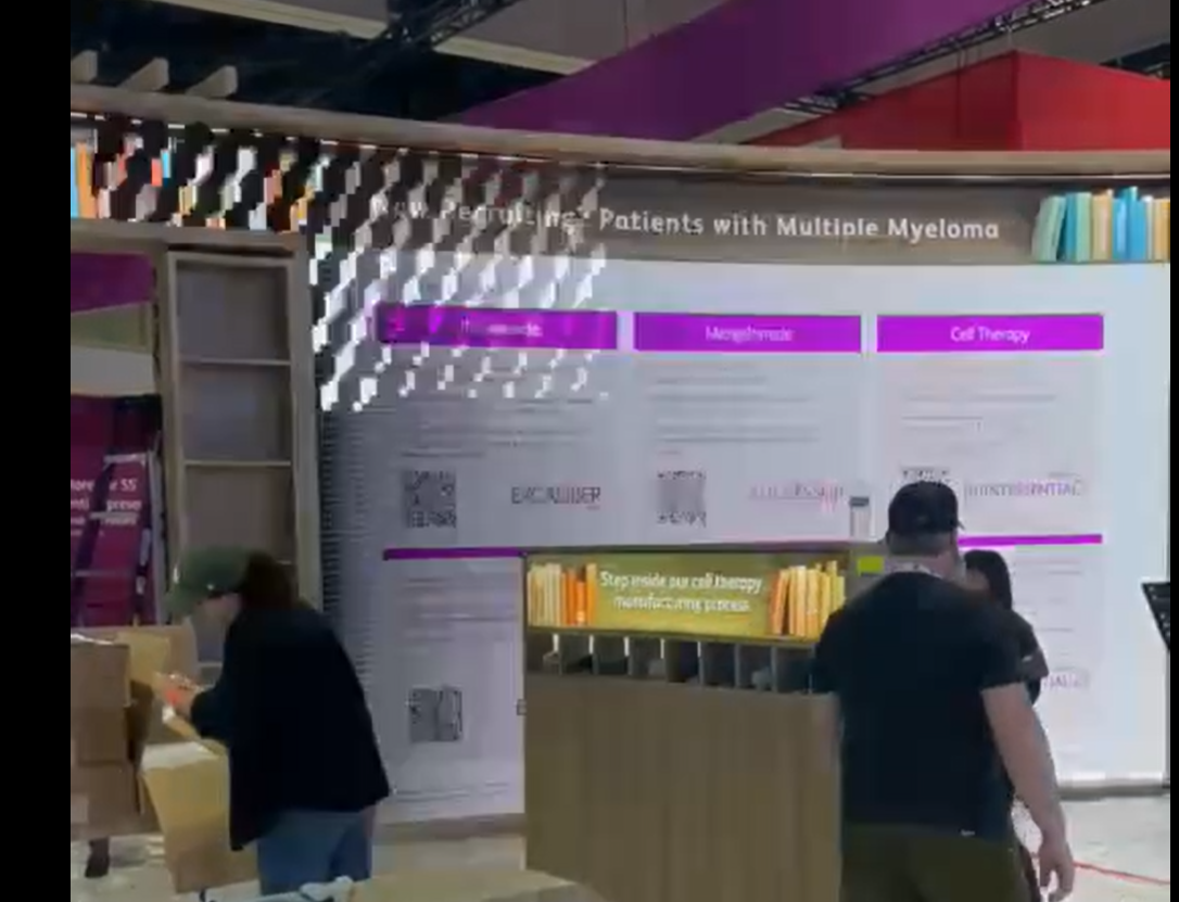

Hi everyone, I fixed an issue on three of my computers by reinstalling the NVIDIA driver. During the installation, I chose to ignore the optimization step, and it seems to have resolved the problem. I'm not sure if this is the correct way to do it, but I only experienced one crash in a very long time of working like this. Resolume guys, you need to fix this, please!
Re: Output flickering
Just saw and read through this, and I have a hunch that some of the issues reported here may be caused by different things. Intermittent flicker is one of the worst issues to have, so hopefully it can be sorted.
First off is the driver things. Rather than looking at the driver that works (516.94) we can look at the one after (517.48) to see what has changed. The thing that sticks out is fixes and/or improvements to flickering in multi monitor systems(!). It is mentioned a few places, but the main takeaway is that if you have a multi-monitor setup with different refresh rates for the displays, things might flicker. Try setting the refresh rate to the same for all outputs to see if it helps. Also turn off any V/G-sync if that is enabled. I you already have the same refresh rate - try seeing if changing it to mismatch will help (https://us.download.nvidia.com/Windows/ ... -notes.pdf).
If that doesn't work, there is the slightly more exotic issue of cables. Flickering in white images/slides is usually a sign of bandwidth issues. Check cables, check cable specs, and then check different manufacturers, and when that is done, check different lengths. Cables "within spec" may have signal reflections at certain resolutions depending on the cable length. A longer cable may work better than a short one and vice versa when having unconventional resolutions - and those are never tested manufacturer side. Also use the ports on the opposite side of your power input if on a mac because Apple. Cables sure are fun! (no.)
Then there are carpets and static. Make sure cables are properly shielded and grounded between extenders and racks. Also that the house system installers actually used shielded plugs instead of just shielded cable when they did the install.

I'm seeing this problem too with the latest release. I get a flash of checkered pattern along the bottom and lower right quadrant of the output display(s), sometime most of the right hand side.
