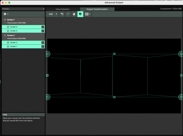

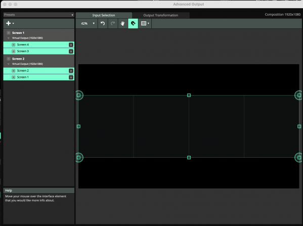

In your advance output. If you have two screens and both screens have one slice. I would give both screens two slices, one for each face of the wall it's projecting on. Then you get eight points that you can edit to match up your wall. see picts.
I hope this helps you out.

tijnisfijn wrote: Wed Oct 23, 2024 11:21 In your advance output. If you have two screens and both screens have one slice. I would give both screens two slices, one for each face of the wall it's projecting on. Then you get eight points that you can edit to match up your wall. see picts.
Thanks for this. That's actually a great idea. I'll work on that during downtime.
Would you advise doing geometry correction with the projectors, or not bothering and just aligning all in Resolume?
