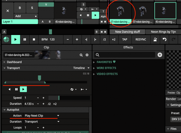

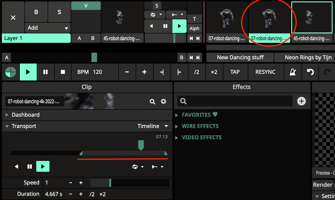

I would copy the clip that you would like to have continuously playing. Then in the clip transport, I would set the first clip to play the first half of the movie(or as long as it needs to played before the other clips needs to skip), and then the second clip to play the second half and in the clip auto pilot of the first clip set it to play next clip. I hope that will solve you problem. If you have any more questions, let me know

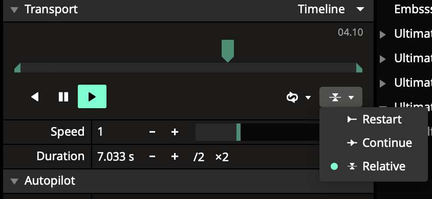

ok that you could do it like this: copy the clip. Set the second playing clip on playmode relative. Like you see on the picture. Now, you can switch between clip one and two and clip two will continue where clip one used to be. I hope this will help you out.
