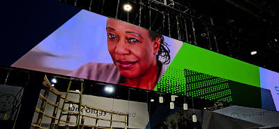

Its not any refresh issue or any thing, its happened when i updated my graphics card from 2080 to 4070ti.
I have same issue when using the 30 and 40 series cards. So many times i hade this issue till now and im always switching the resolume to othe softwares like kommander. Recently i updated new driver and new 7.15
Not everytime when i play only graphics there is no flickering, but when i use it in conferences i put the exact led pixel background video of the event (dxv3 converted)
Or using a png of same pixel size it starts flickering.
In the above video I attached in the chat its a small wall below 1920x1080 led also flickering. Client are really bad with this and i cant use this in any conference event.
Please give a solution, i did my maximum to solving this
Gfx card of 40 or 30 series peoples have this issue please report this

I have had this issue also several times with Resolume. Random weird patterns popping up at the bottom of one of the outputs. Happens at random will occur from 10-30 seconds, then go away and not reoccur for hours. Also switched to MPC and it never came back.

Putting my hand up to say I’ve also experienced this issue. Those patterns in the image of the previous forum post is exactly what we see.
