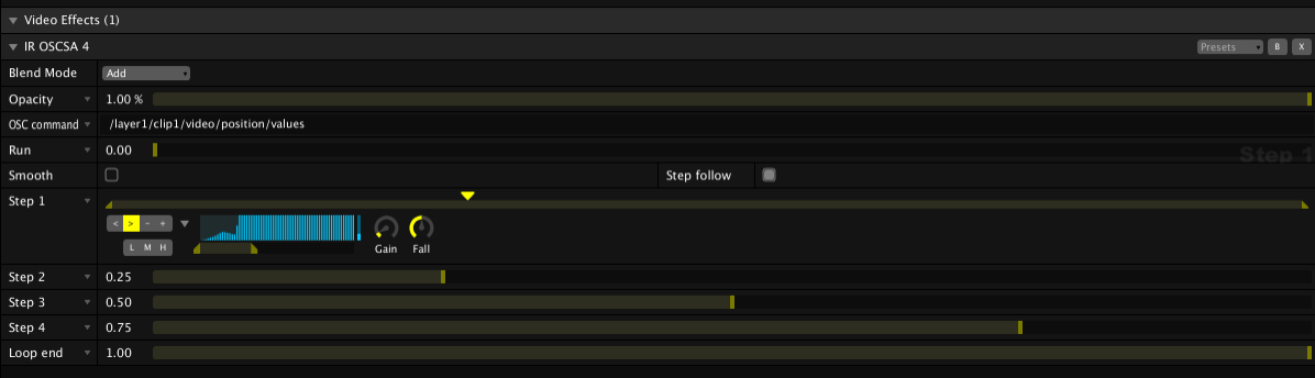

Re: Link audio FFT to timeline
Hey Gabemott
I'd love to help you out, but it depends on what OS you're on, and what you're going to be using to get the OSC data (Processing, Max, QC)?
Now that I think about it though, it's even easier to (ab)use the IR OSC Step Automation plugins (http://irworkshop.com/component/content ... automation) for this:
1. Apply any of the plugs (I guess the IR OSCA 4 makes the most sense), on a clip.
2. Set the 'OSC command' to be playhead of the clip (for instance: /layer1/clip1/video/position/values for clip 1 in layer 1).
3. Set 'run' to 0.
4. Set 'step follow' to on.
5. Set 'step 1' to be controlled by external audio FFT using the normal drop down.
6. Sit back and watch that clip bounce to the beat ;)
IROSCA FFT to playhead.png (37.06 KiB) Viewed 19359 times
Hope that helps.
