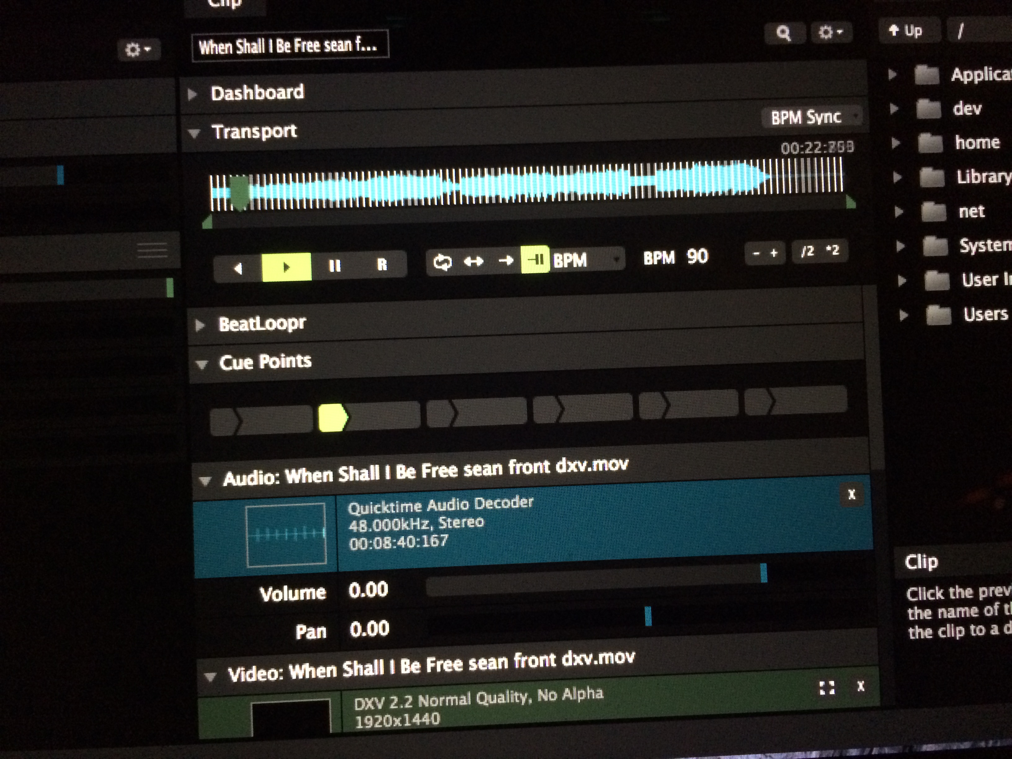

BPM info does not save on restart or clip moving

3. The bpm info not saving on the sample with the blank audio clip seems like a definite bug to me as well. I know I have a fix for it (x the audio out of that clip and just type in the number of beats), but I'd encourage the developers to look into this issue as well. As I've mentioned, I could try to upload this file for you to review.
4. Occasionally, all of the letters disappear from my cue points, and I can't really sort out if it's me pressing some hidden shortcut to clear them, or what? Check out my attached image. I am just not quite sure why most of the time that cue point row is filled with letters (qwert), but occasionally they all blank out. All of the MIDI triggers work with them all blanked out or not, this was simply a curiosity of mine to figure out what's happening here

4. Those letters indicate key mappings you've made. Could it be you're using Comp Key Mapping, and just don't have any shortcuts assigned for that particular clip?
