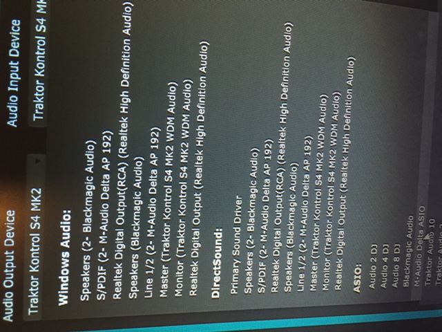

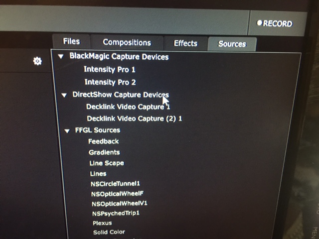

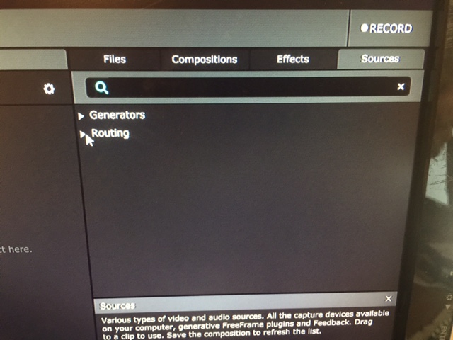

Still not able to see Blackmagic cards in R6 but can in R4 see attached images. However R6 can see the audio inputs of the cards

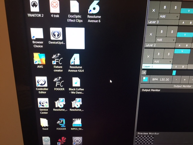

Not able to load Dotoptic effect clips file. When I drag the file I get the no entry error sign
