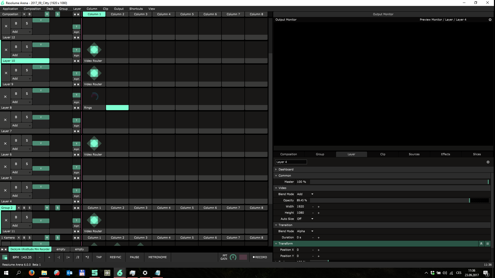

I would like to start reporting some bugs and tips for improvement.
:arrow: Grouping is one of the best functions. However if I click in existing layer and add it to new group it distorts the order
In attached example I have tried to make a goup from layer 4 and it added a new group below and put layer 11 there. Adding more layer to this group causes growing error. But when I drag and drop the whole group somewhere else, it sorts well afterwards.

1. do you maybe remember what you did before? moving layers deleting layers etc, I can't recreate, maybe the key is something you did before creating the group.

aeldryn wrote:Hi,
Are you saying that when you move layer 11 into a group below layer 4 you now skip from layer 10 to layer 12?
