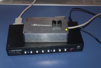

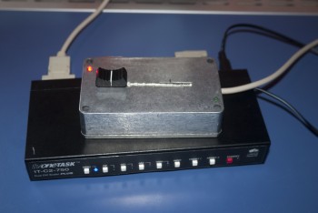

I built an arduino controller for the 1T-C2-750 that can do this, and it works very good! I had a lot of problems while making this (null modem cable that wasn't a null modem) but now it finally works (after more than a year!). The 1T-C2-750 can change the opacity in 18-56ms.

All the pictures of my module (don't mind the bad cuts in the aluminium, I did it with things I had laying around)
