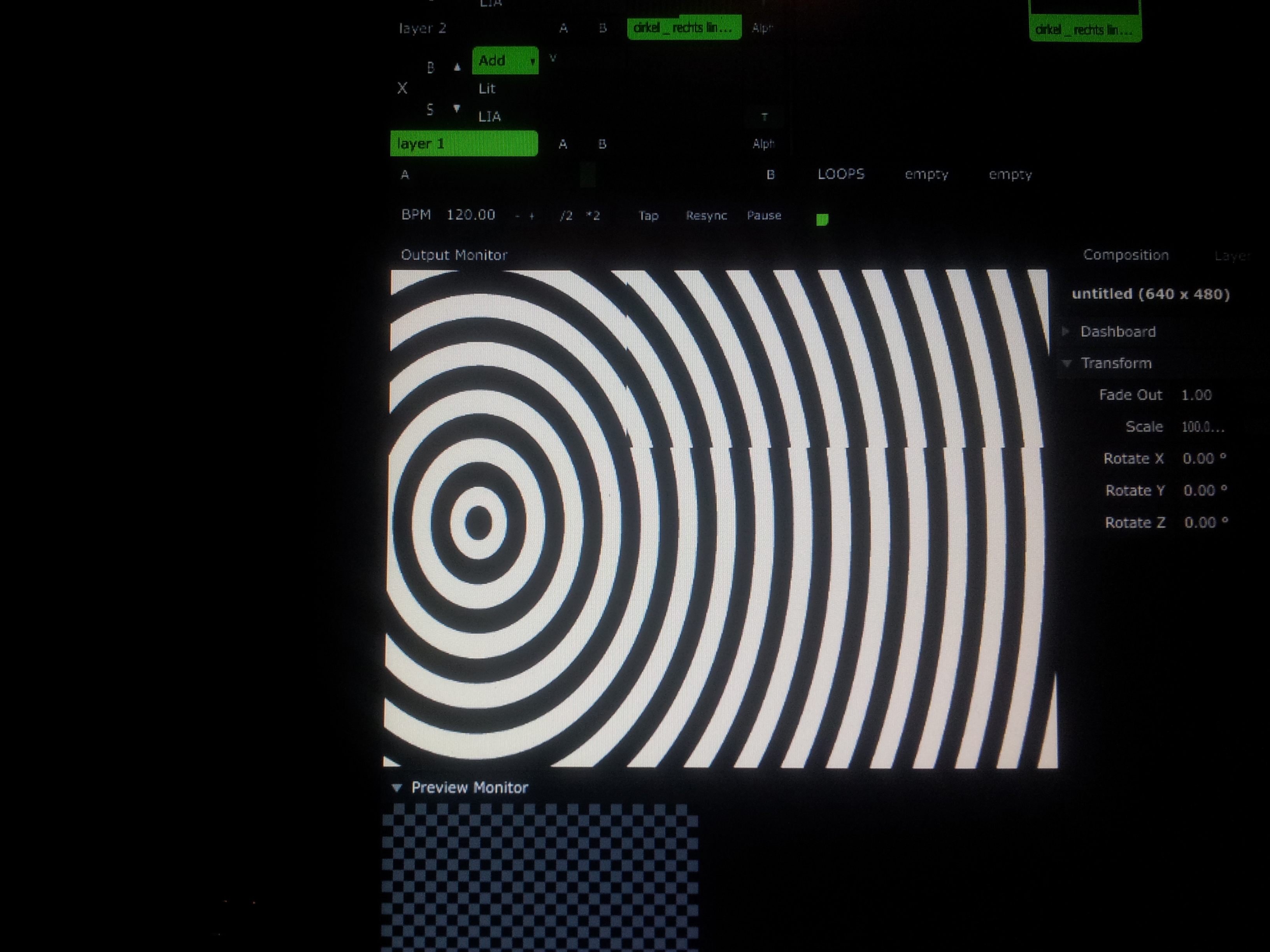

and when i try to make a screenshot it imediately goes to a 'good' frame. So i made a picture of it.
The lines should go on, but there is a weird block in it. And for the rest it doesnt play smoothly.
Plus on a secondscreen it appears ok... but on the output monitor it keeps on doing it.
glitchy block
glitchy block

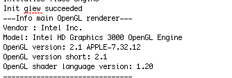

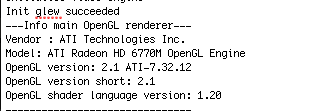

Re: Output monitor ''Refresh'' Problem - stutters
Becasue the output monitor is pretty much for your eyes only and you probably want it updated as fast as possible, we're not waiting for screen refreshes. So there is a possibility for tearing.
As long as it's good on the secondary output, I wouldn't stress out too much about it.
You could give a quick check in the log to see if Resolume is actually running with the proper GPU though.
Intel GPU ( Bad ):
Discrete GPU ( Good ):
kratata
Posts: 17
Joined: Thu Sep 02, 2010 10:56
Location: Den Haag
Post by kratata »
Thanks.
arena runs on the Amd - so thats nice to know.
