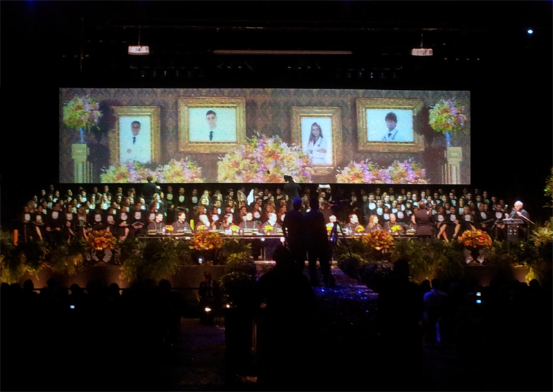

It was an university graduation cerimony. Behind 150 sitting graduates, ther was a 16m x 3.5m panel, a printed banner in other ocasions. Not this time. Two projectors were used to map a decorative animated background.
The edge blending setup was a little bit tricky and not as simple as the theory states.
I haven´t mastered it yet, specially the proper way to change values in order to match differences in luminosity and most specifically colors.
I didn´t have the opportunity to film that. Only to take a couple of pictures.
The blending was pretty ok but even at this distance you can notice difference in colors, from side to side.
Tips or suggestions for a better understanding of this process is very welcome.
Thank you!
Sharing My First Live Edge Blending Mapping

decent projectors helps a lot.
DLPs made for blending.

yeah your best bet is to get some high quality projos that edge blend in the projo itself.
Also you want projos that have similar lamp lives
Obviously you want to use two identical projectors.

Those were. Two 15K DLP projectors.deepvisual wrote:decent projectors helps a lot.
Humm haven´t checked that tech yet.LXConcepts wrote:yeah your best bet is to get some high quality projos that edge blend in the projo itself.
Those were "brothers".LXConcepts wrote: Also you want projos that have similar lamp lives
tks

i just did a weeks worth of this.pfelberg wrote: Tips or suggestions for a better understanding of this process is very welcome.
Thank you!
you need a light meter to do it properly, but they are hard to come by. otherwise you have to spend an hour or two on each projector balancing the uniformity, RGB global values & then the individual RGB values by eye.
more here - download the user manual
http://www.christiedigital.co.uk/emea/b ... #downloads
page 3-62 onwards
