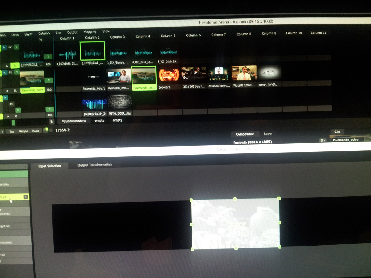

Would love to find an answer to explain this behavior in the video mapper:
I am attempting to create individual video maps for each layer in resolume
layer 1: Clip 1 shows up in the center location in the video mapper
layer 1: Clip 2 in the video mapper is off center and any attempt to resize or move is not effected in the video mapper unless i switch from layer 1 as source to composition.
attempting to attach pictures is failing so hopefully my description is accurate enough will try to figure out why I can't upload

example 1
example 1
example 2
example 2

so to explain more clearly:
I have a pixel map canvas size of 8016x1080
some of my video content is full resolution and is mapped to screens a certain way
some of my other content is standard hd res and is mapped to specific screens on stage but not the entire stage
in the photo examples both clips are position x and y at 0 and anchor x y z at 0
when i click each clip inside resolume it shows up in my playback monitor in center position - where it defaults too and where i want it to be for the mapping to work
The issue is when you open up the advanced video mapping tool you will see that in example 1 the clip is in the middle but on example 2 the clip is all the way left. If I set the slice source as composition it works as hoped but when i try to select the actual layer the clip exists on then the strangeness happens.
It gets weirder because if I drop in 10 clips 8 will be centered and work as expected but clip 9 will be off center and size and 10 will be the same but in a different spot. Also the issue tends to follow the clip so even if i reload the clip it still shows that behavior. IF i drag it to another layer the problem follows clip. Very bazzar.
