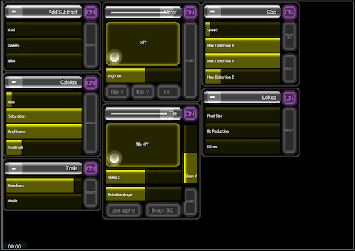

I continued to work on my Lemur for iPad Resolume template recently, and it would be nice if the Resolume interface could somehow reflect if I bypass an effect. As the space on the screen is limited, and if an effect is off, there is no reason to see the parameters.
I have around 10 VFX at the composition level, and all are unfolded so I can have an overview. I'll post the template once I figured out how to deal with an annoying bug (OSC feedback controls wrong sliders in Lemur).
Are there any news on the future of OSC in Reoslume 5?
Out of curiosity: did you change the behaviour of VFX in case the opacity is set to zero. It seems that an effect was bypassed in case of zero opacity in previous Resolume verisons, now having a lot of effects (not bypassed) but at zero opacity leads to enormous decrease of the frame rate.

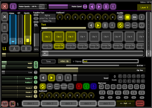

Some pictures of my Lemur Resolume template (still under construction):
