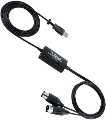

I would like to connect the usb controller to a midi splitter, but I don't know if the midi splitter understand a MIDI-USB device.
In each laptop (maybe I have 3) I'm going to connect a USB MIDI interface like such of Roland:
But I don't know how to connect a USB controller to a midi splitter...
